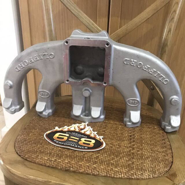

Is your intake that big and sweeping to really need a different booster?
Just a file pic here.

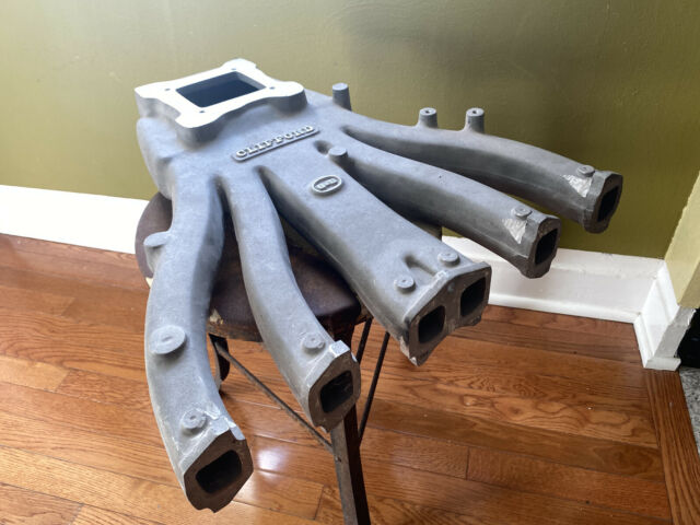

It looks big but not huge. Just curious? OR is it the big LONG runner intake?
Hard to find any info, should be a cool install when done.
