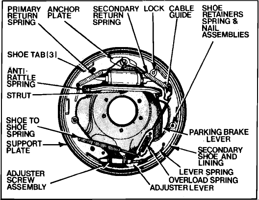

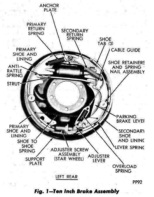

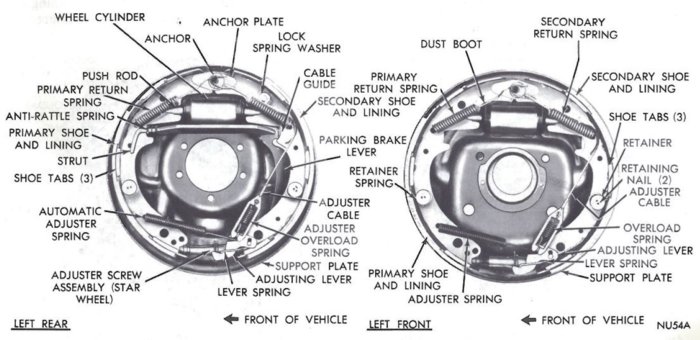

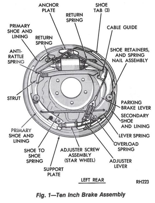

Here is a few pictures of drum brake hardware. I hadn’t looked at each picture – but I suspect minor differences in each picture – so the picture should either match or come really close to have. At work so have limited information to pull from, atm.

1970
1977
1982

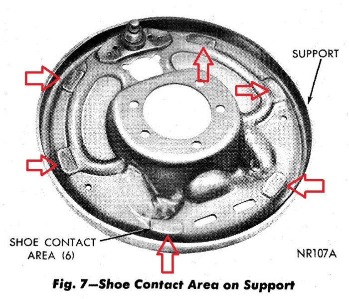

There are three raised locations on backing plate, per side (6 to a plate) that need a touch of wheel bearing grease (a thin film, only) at each location.

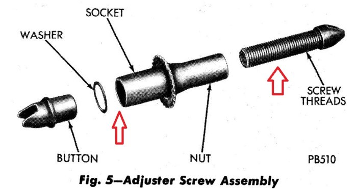

The star adjuster – I have heard from several sources two different opinions as what to do with it. One set says to apply a very small amount of wheel bearing grease to the two spots marked by red arrows.
The other set of people say to make sure all surfaces are not rusty, clean and just leave be (ie: dry).
I don’t really have an opinion as to which way - except for if car will be parked more than it will be driven – a very thin layer of grease would be a good idea (to prevent rust).
If you plan on driving car every day (like I do), dry would be best.

1970
1977
1982
1986
