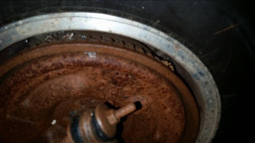

If you have 14” wheels on car then the only choice will be 10” rear drums.
You might be able to get a feeler gauge between 15” wheels with 11” drums.
This picture is an 15” aluminum snowflake wheel mounted to 8¼” with 11” drums (police sway bar is also seen).
