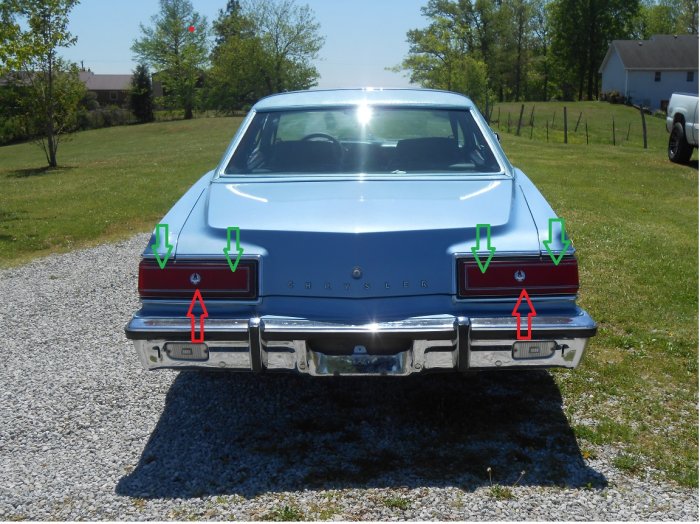

How do I get all six of my taillights to come on when I hit the brakes or use the turn signal instead of just the four on the inside and outside? I realize that it's the way it was designed, but I think it would look a lot better if all six would activate.

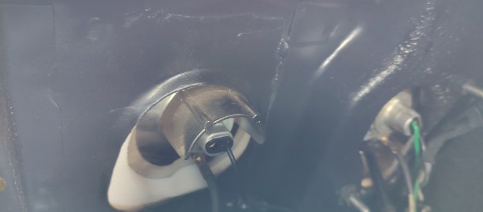

Did a cool ride today with the LeBaron and took a picture - amazingly, in my trunk there's a socket for dual bulbs, but only one wire going in...
Take a look behind the plastics and you'll know what to do. The right socket is the "outer light", left socket is the middle one.

Pretty much all you need to do is, change the sockets to ones with 2 wires, and splice the brake/turn into the existing wire for each side.
