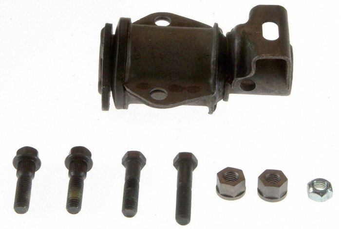

I still can’t picture that section of steel to be broken off (and I’m not doubting you).
The best fix (if parts were still available) would be to replace the torsion bar end (the part that is broken with the shell that connects to the control arm) – but hadn’t seen one for sale for a few years now.
Moog K7289 – and several others were making them for a while.
I wish I had bought a dozen sets a few years back – so much for hindsight.
