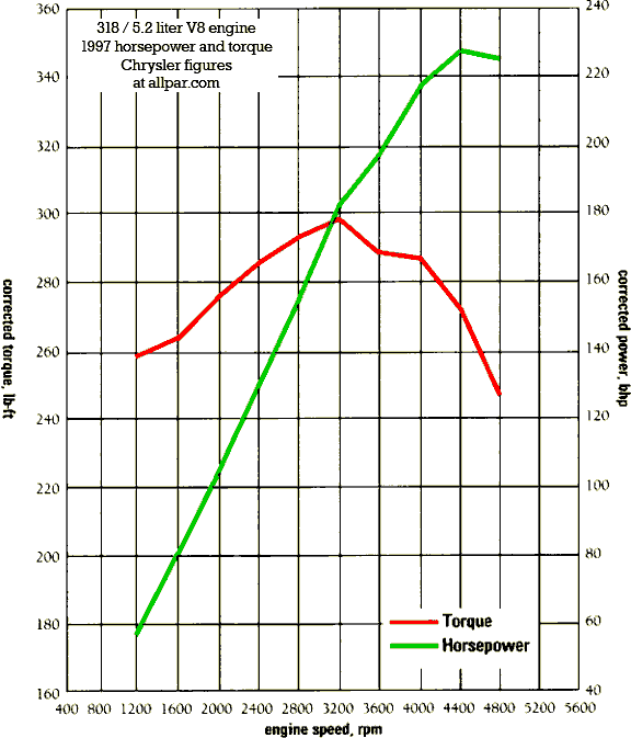

With No Other Changes, you cannot wake up the bottom end with a bigger same type cam, that has a later Ica. The later Ica drops pressure every single time no exceptions. Less pressure means less power.
What you wanna do is what the manual-trans guys do, which is slip the clutch to a higher rpm where the power is.
Have a look at this and you'll see what I mean;
Say you currently have a TC with a 1600rpm stall. On this graph, that is 80 horsepowr.
Suppose you installed a 2800TC and found ~155 hp.
There is no other thing you can do to your engine with an automatic, that can touch a 75 hp increase at zero mph, short of supercharging it.
Once you have a decent TC in it then we can talk cams.

thanks for the input ,a new higher TC is probably were i want to go,motor already has reground performance RV cam now( no specs on it) tks geo
