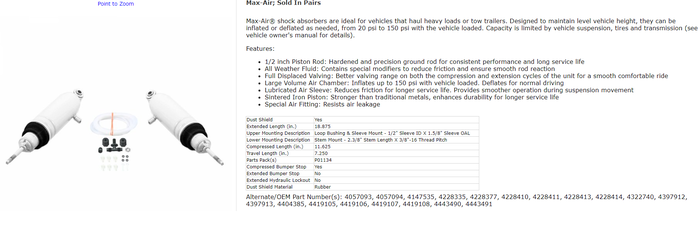

Can I put the air assisted shocks in the back of my '88 5th?
8v-of-fury
May 7, 2014
435
40
Orillia, Ontario
Not necessarily to tow anything (although I'd like a hitch on it eventually..) but when I have my own fat ass plus 3 other people she's well loaded down lol. The leafs are pretty soft, so I imagine it is really the only way aside from stronger leaf springs to be able to have the rear end handle more weight.

If your leaf springs are original it would be worth looking at replacing them or finding a shop to add a leaf especially if it's a regular occurrence.
The top shock mount is sheet metal and not made to take a heavy load. But people have used air springs with no problems before.

I've been using those air shocks in my Aspen for a couple of years now, and I'm more than pleased with how they're holding up.
The Aspen's rear was sagging a bit, so with stock front end height I was looking too raise it an inch or so without breaking my budget. I'm running 55 psi pressure in them which gives the rear kind of a solid feeling compared to the old shocks.
I also used some exhaust wrapping around the pipe at the axle bend to protect the boot a little.
I know the right way is replacing or rearching the leafs, but it's really hard to get this done here in Norway unless I take a second mortgage. I know of a five leaf setup from a parted out wagon, so maybe next spring...

Air shocks are going to make your car ride like shit. Don't do it.
Agreed. Avoid air shocks.
Could you guys please say something about how the air shocks makes the ride so crappy?
As I said my air shocks was a temporary fix for my saggy rear, but you know how it is with temporary things when they work out OK....
When I say it did work out OK it was compared with the old shocks, probably the original ones.:eek:
Maybe I should quit goofing arond and just replace the leafs. Then again the Aspen is kind of a sunday/nice weather car. Never sees any hard cornering. Your thoughts would be appreciated.

To put it bluntly: Just replacing the leafs is the simplest thing to do. The air shocks would be a band-aid.
