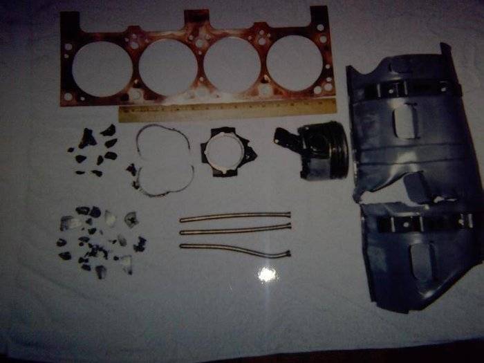

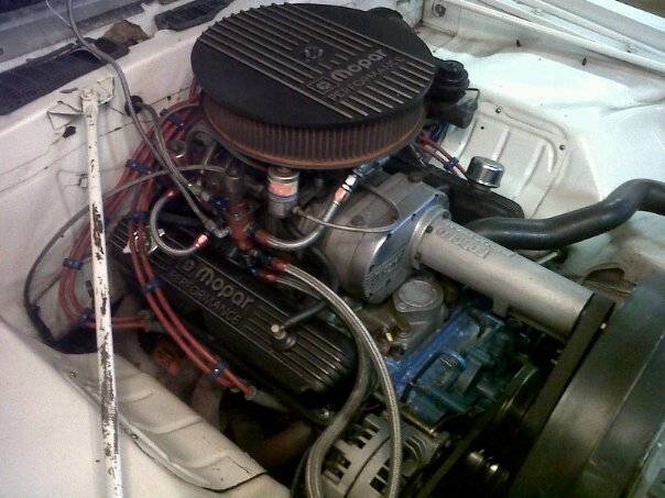

7000RPM and HydroLock did this damage on a 100,000+ mile stock lower end, with 6PSI of Roots boost AND a 150HP shot of N20.
The stock bottom end held together quite well under boost, IDK what I'd shift at as the tach only goes up to 8,000RPM and I'd bury it, quite often.

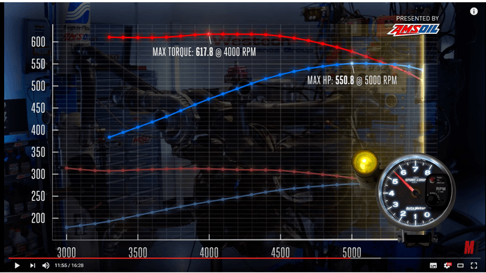

I'd be going for 10-12psi tops, intercooled if I can fit it easily, and never really expecting it to spin more than 6000 as an absolute RPM ceiling. They made that 5.0 make all of its torque between 3-4500 and the power was solid to 5500. I do believe this was on 15psi, so 10 should achieve numbers proportionately lower than this.. but still, goddamn. The amount of torque would make the wide gearing in the trans and high rear gear useful lol.

That 5.0L Ford is a Mustang GT engine with EFI and a performance cam from the factory; starting out with a more HP-oriented engine like that definitely helped them achieve 550 HP. We know 14.7 psi of boost will theoretically double HP but if you're starting with only 150 you'll be making a whopping 300, and that's a lot of boost for a bone-stock 318 bottom end btw. IMO starting off with maybe 6 psi and working your way up to 10 or so is the safe/smart way to do it. Careful with the small turbo selection as well, a small turbo on a big engine will be inefficient and create a LOT of excess heat due to the massive backpressure on the hot side of the turbo system.

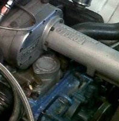

MirandaMegacab do you have better pictures of your intake manifold – more specifically on where/how the upper radiator hose attaches to the intake?
I have considered this option for 30+ years but haven’t ever seen an intake thermostat that is friendly with the supercharger snout – so always blown off the idea (sic). I can’t make out details – but it appears this intake has been modified to work, possibly.
