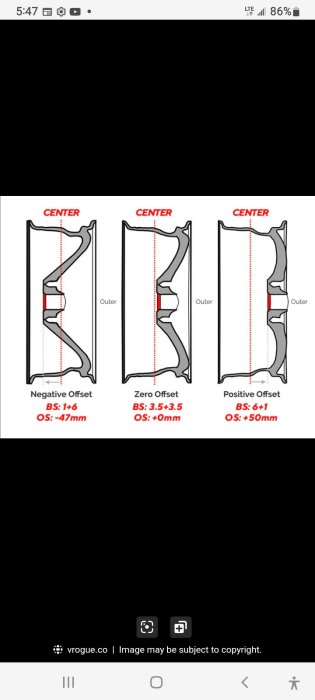

Most any FWD vehicle uses positive offset wheels. That refers to the center disc of the wheel. Basically it means the mounting flange surface is outside of where the center meets the outer rim. Kind of hard to explain without pictures, sorry! Keep in mind, wheel offset and wheel backspacing are two different things.

Now I understand what you are saying.. Thanks Aspen!
Also the visual aid is helpful and I can now see in my mind's eye how the FWD cars have more positive offset.

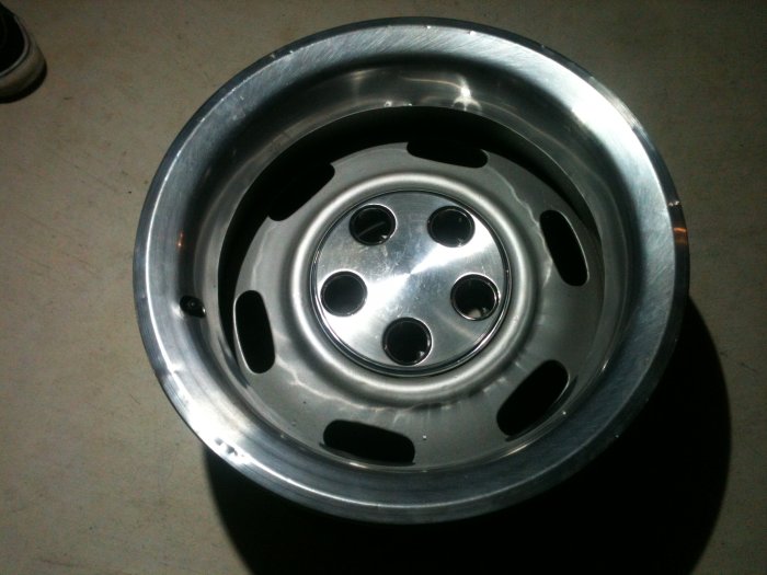

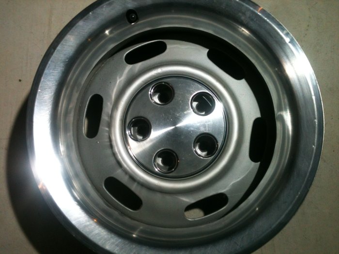

The 91-95 V6 extended Wheelbase used a 5 by 4 1/2 bolt pattern. The center cap for the wheel is a nice cheap common fit for other mopar wheels. ives a different effect, for sure. It utilizes the 3 screw hole mounts from the back
I like the look, simple, clean, affordable...
Thanks for that recommendation! I am not seeing any V6 vs. 4 cyl options on car-part.. but if I can confirm that, I will get some!
