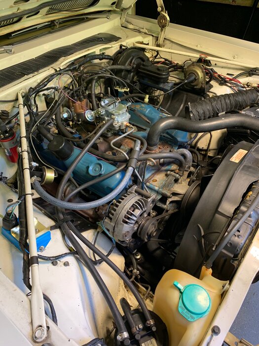

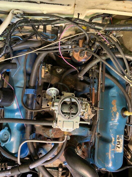

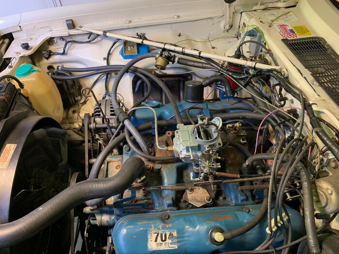

I have taken some pictures of the engine bay, in case anyone can spot a problem.
