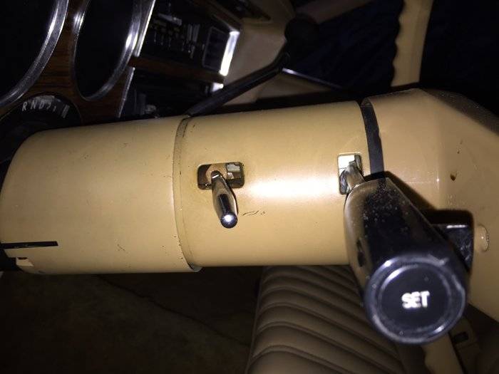

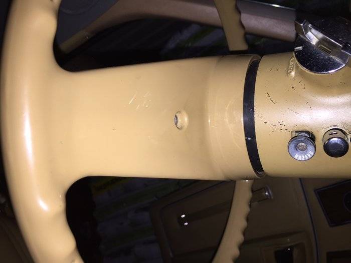

Hi guys
My ignition lock is a bit loose, so I have decided to change it.
I just don´t want to break anything, and the Haynes manual is no help at all.
The steering column is with tilt - pictures attached.
I guess a lot of you have done this before - any tips ? :)
