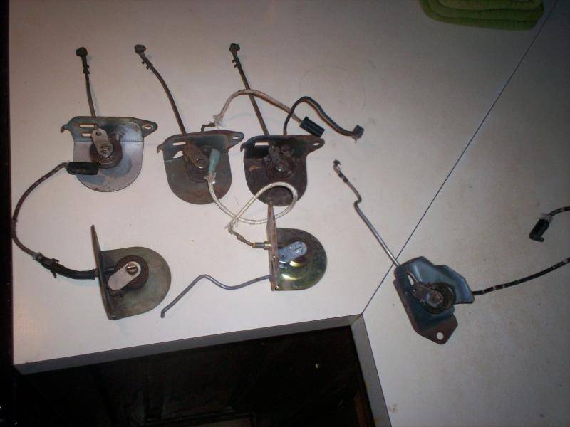

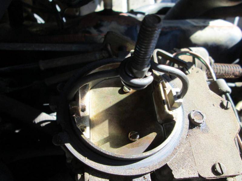

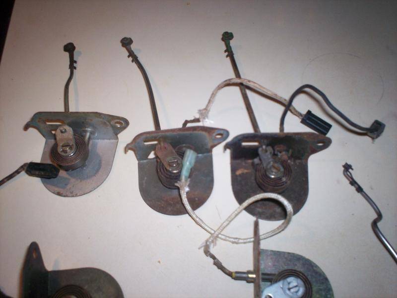

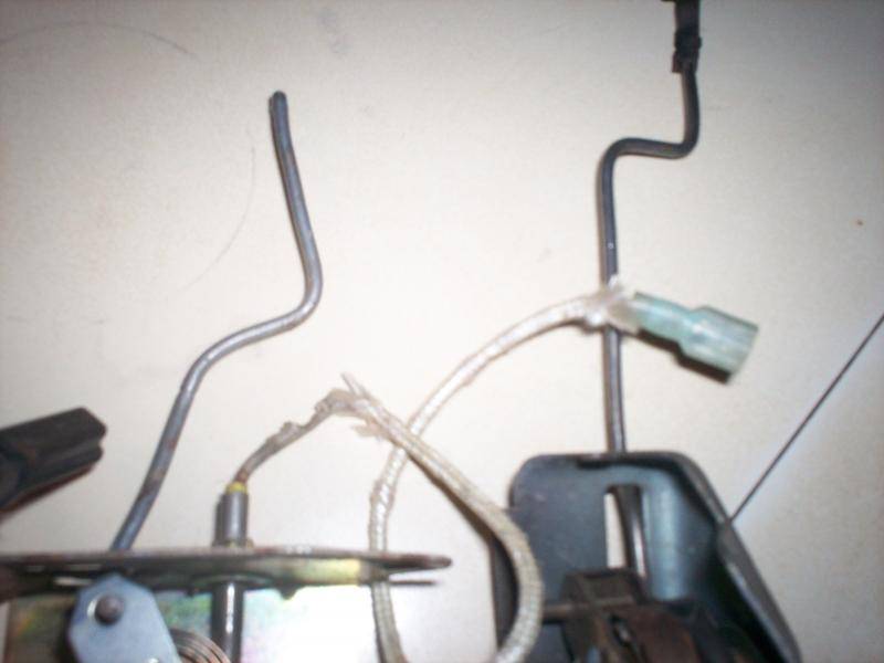

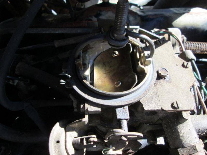

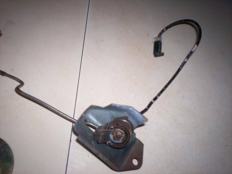

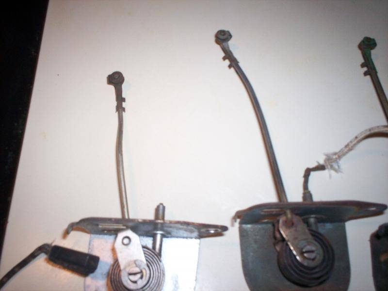

Quick question, since my service manual isn't here yet. '86 Fifth Ave. First start of the day, any temperature outside. One pump on the pedal, starts right up. High idle, choke stays closed, loads up bad. Takes about 3 minutes before it will kick down and clear up. Checked voltage from choke thermostat switch. 12 volts in, 10.75 volts out. Replaced choke thermostat. No difference. Is there any other adjustment? I'm about ready to just wire the choke open.
