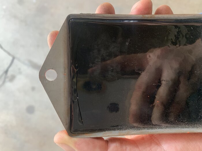

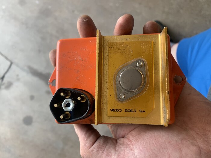

Sunday afternoon, my car started running very similarly to what you’re describing. By Sunday night, the car was stalling when I would shift into reverse or drive and eventually I couldn’t even get the car to start. Fortunately it was already in the garage by this point.
Anyway, after doing a number of checks that the others have mentioned here, it ended up being my “new” Jegs ignition box that I installed about 6-8 months ago.
If you haven’t checked over your new ignition system, I wouldn’t rule it out just yet.

Correct, the casing cracked and the module failed. Most of the modules currently on the market are prone to premature failure. They’ve left more than one person stranded, lol.
