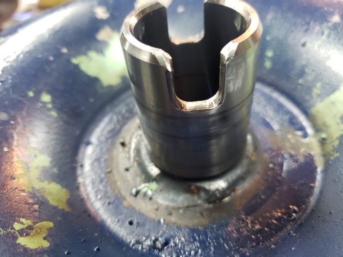

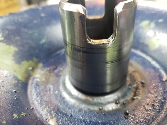

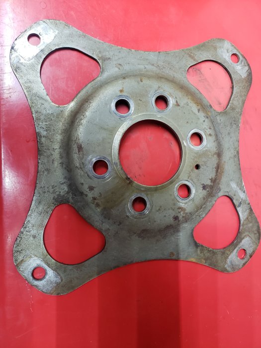

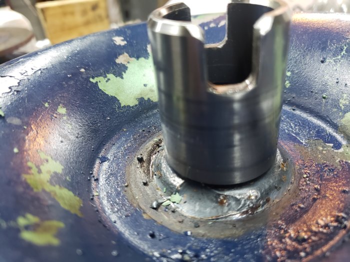

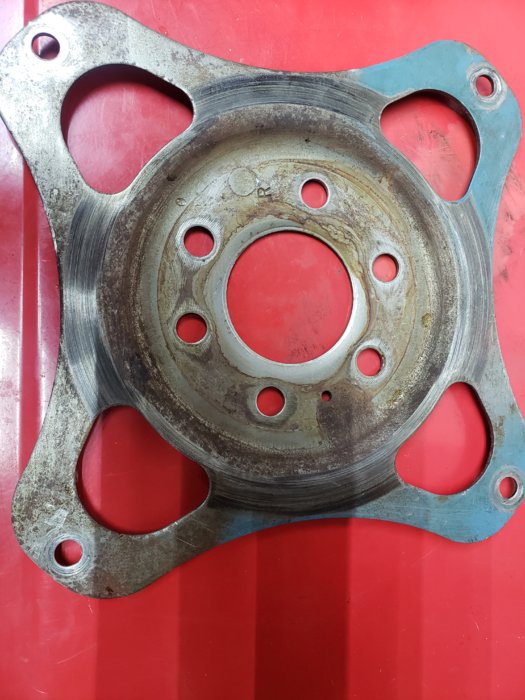

    Does anyone see anything wrong with the torque converter and or the flex plate???

    The flex plate was rubbing something on the back of the block. Not sure what it would rub unless the thrust bearing is bad and the crank is getting pushed forward. Other than the funky weld, I don't see anything on the converter, looking at a photo anyway.

    Probably rubbing the dust/spacer shield but I saw that too.. will have to dig further into that also...

    check your convertor bolts. Usually when the thrust bearing goes the bolts hit the block and then you can see the damage on the bolts real easy plus the block will be grooved, plus the bolts will take out the the rear cam plug.

    Engine does not have very many miles on it, runs very strong......
    Converter bolts were tight, crank bolts were tight , absolutely no sign of anything hitting anywhere except for the flex plate rubbing the dust shield/starter shim, which I am hoping somehow was the noise......
    Replaced the flex plate just to be sure but no sign of any cracks... converter front pump drive shows no signs of damage either.....

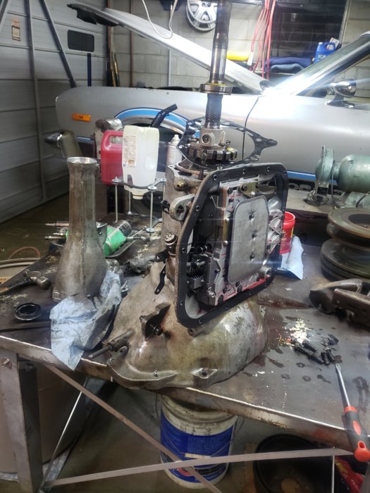

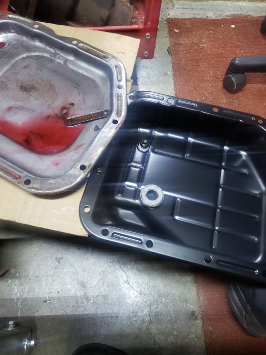

    However while laying on the floor trying to stab the converter back in while under the car, let's just say my talent ran out and I had to put the transmission on the work table so I could replace the front pump seal that I f'ed up..... so since I had to go to whatever it takes (WIT) for parts I might as well replace the tail housing gasket, output shaft seal, speedometer oring, and the rear bearing snap ring cover gasket...... hince the snowball effect......
    Plus I added a A500 pan for cheap that BudW recommended....
    Now Thursday I will try to put it back in the car so I can drive it again.....

    Before the transmission gets stabbed in, the wear pattern on backside of flexplate has me concerned.
    It might not be easy, but I would check for crankshaft end play. This might require removing the flexplate, getting a dial indicator and a crow/pry bar. Move (either) the balancer forward with pry bar (or rear crank hub back), and zero the dial indicator. Then pry on the other end. Factory specifications should be about 0.003” to 0.008” (or so – I couldn’t find the spec in my ’86 FSM, so going by memory).
    If you can feel definite movement when prying on both ends of crank, then STOP! You have other issues that need worked on and that might very well be what is clunking.

    I could not get any play out of the thrust bearings ,I revved the engine as well as snapped the throttle over and over I could not see harmonic balancer moving at all oh, this is after checking the transmission out......
    No I can manipulate the dust shield and make the noise change,.. I'm pretty sure I bent the shield installing it last time and even more this time.....

    Finally removed the shield and the noise is gone...
