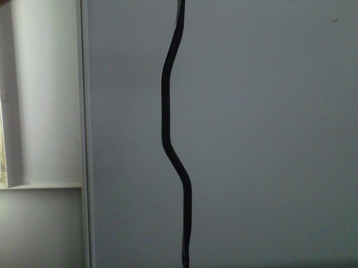

Mar 13, 2011 #1 P prodart67 Member Joined Mar 9, 2011 Messages 12 Reaction score 1 Location NH Does anyone have a pic of the rod that goes from clutch pedal to z bar?,mine seem bent and the pedal is really hard to push. thanks
Mar 13, 2011 #2 bremereric FMJ Body Moderator Joined Feb 25, 2011 Messages 3,555 Reaction score 247 Location Jackson Missouri prodart67 said: Does anyone have a pic of the rod that goes from clutch pedal to z bar?,mine seem bent and the pedal is really hard to push. thanks Click to expand... This is the best I have for now
Mar 13, 2011 #3 bremereric FMJ Body Moderator Joined Feb 25, 2011 Messages 3,555 Reaction score 247 Location Jackson Missouri Here's a little better one showing the bends in it...they are susposed to have these bends...another possiblity is that someone replace the clutch and pressure plate with a higher spring pressure...

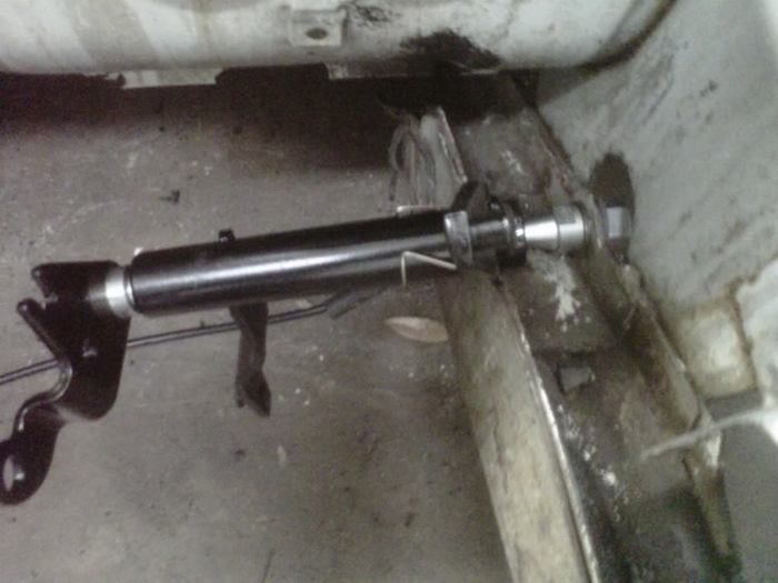

Mar 14, 2011 #4 bremereric FMJ Body Moderator Joined Feb 25, 2011 Messages 3,555 Reaction score 247 Location Jackson Missouri Here is how it is mounted and should look like
