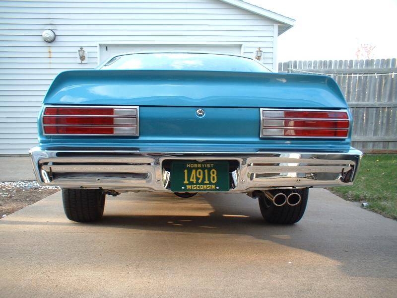

Probably hard to tell in this pic for an example but, I did the tail lamp "chrome" with the Eastwood Liquid Chrome System.

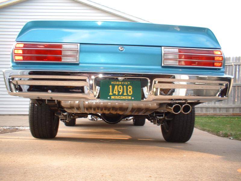

Oops, wrong photo above and can't finger out how to change it. I think this one is a little clearer view(?)
