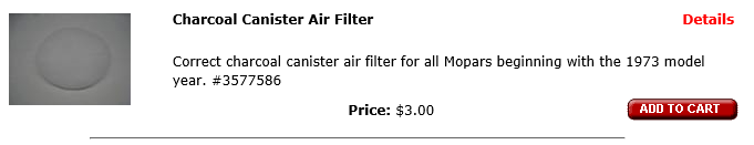

There is a replaceable air filter on bottom of charcoal canister that sometimes get stopped up (not often) or a problem in canister itself (again, not common).

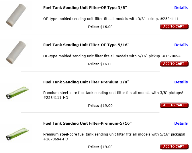

The in-tank filters look like this
from this website
http://billrolikenterprises.com/search.asp?nobox=&scat=23&stext=filter&stype=&sprice=&pg=3 . There are other locations to find one, as well. The Dodge part number is 1670694.
They pull off/push on – but generally, they come off in pieces. Generally, if the fuel sender is out of car, it is wise to replace this filter while there.
This is a (poor) picture of a typical charcoal canister air filter
I went to look of the number for a replacement filter for your car – and come to find out the filter is not available - it requires a canister replacement (which is part # 4241839 (stamped 4227010)) - or some other modification.
