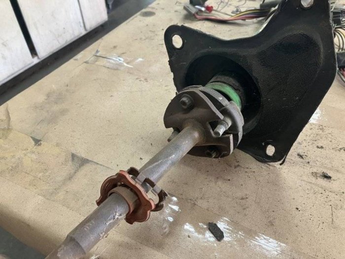

The tilt columns that I have seen all use GM/Saginaw units that use a two piece steering shaft.

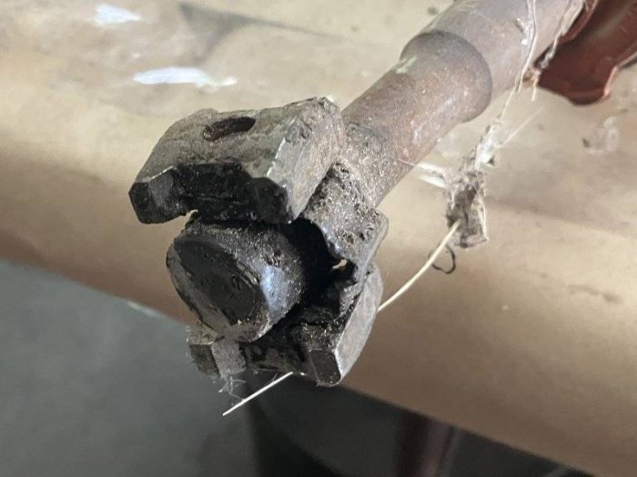

They had a rag joint near the firewall. The shaft that attaches to the steering box itself is a bit of a hybrid. The Mopars used the pot coupler to allow for some misalignment as well as having plunge capability.
The GM design used the rag joint to accomplish the same thing. It is odd to see both integrated into the same column but since Saginaw built these and modified them to work in Mopars, it makes sense.

I went out to that junkyard and found the Volare. It did not have a tilt steering column.
I did notice that it did have the same style rag joint that my tilt column has. Now I'm curious as to why. Was this some noise reduction measure used on all RWD Chryslers (other than A bodies) from the mid 70s to the end? Did the C bodies have them? I assumed that the M body cars did that had tilt wheel but aren't the M body cars just variants of the F body Aspen/Volare? There is a Fifth Avenue at a junkyard about an hour from here. I may check it out. ALL the Fifth Avenues were column shift so I'd have to remove the gear indicator on top for a floor shift/manual shift application.
The late B and C and all the FMJs had the rag joint, tilt and non tilt. I went a little way down this rabbit hole when I converted my steering to manual and got intermediate shafts out of B and C bodies to see if there was one that would work as a hot rod solution that anyone could do without welding.
