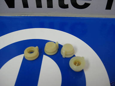

Disaster strikes...grrhh...that plastic wiper arm thingy!!!

Good thing you don't need the one with the hidden park-stop wipers like on the J body. That one is $80+. One guy makes and slls them.
Never did find that part. Either the entire disc would pop off the shaft or the transmission arm would pop off the disc. Soooo, we drilled and tapped the motor shaft and bolted the whole thing loosely together and raised the wipers to stop on the lower windshield. It was either that or no inspection sticker.
