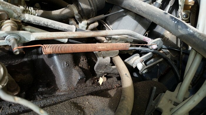

got the car back. now a new problem. throttle is sticking. my kickdown was always kinda loose but it ran fine so it wasn't a big deal. now, it stays at high idle all the time. won't come down after hitting the gas at all unless you pop the hood and flick the throttle lever. after driving and parking the car is up at high idle again. when braking, say we're at a stop light. car seems like it's trying to go forward. and when on a hill, you can take your foot off the gas and the car will go up hill.
the car just had it's starter replaced. perhaps they bumped the transmission? their work shouldn't have taken them anywhere near the Carburetor. car has an aftermarket BBD and still has a 6280 kickdown. worked good this far but was loose. thanks

Check your return springs. Also, what do you mean by loose kickdown?

ok so the idle screw was screwed all the way in. very odd but that's sorted now. where the kickdown links to the left side of the carb, there is a lot of play here. i might need a c clip to fix it in place or perhaps a washer can screw on there? i'm seeing conflicting info if a spring needs to go on the slotted arm.

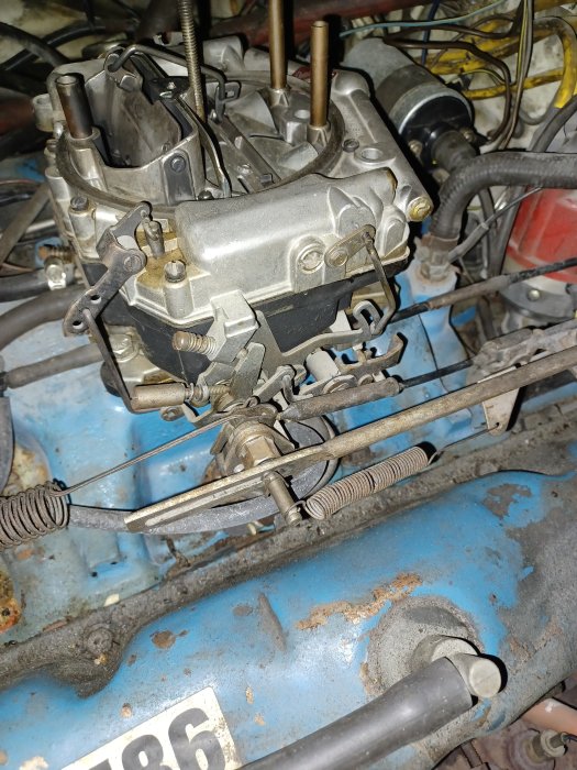

Link: Post in thread 'Carburetors' Carburetors
Are you using the cruise control?
There should also be a diagram in a factory service manual if you have one

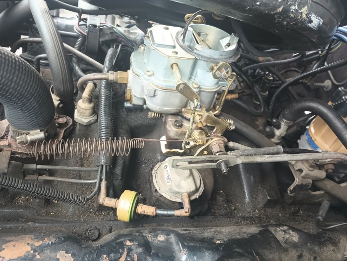

Those springs look old and you're missing one on the kick down. The pics in the link above show a typical set up with cruise control

There's couple different setups. Some have a spring lower down near the fire wall that pulls it up. The ones with the spring at the top are in a different spot. I see the one in the carburetor link is a another style again.

this is a good reference photo. i should have a spare spring somewhere around here. thanks. my car has cruise control but i personally don't use it.

You can see in your pic that the retaining clip is all the way over where the spring should be (red arrow) and that retaining clip should be farther over (blue arrow)
That would cause a lot of slop side to side, probably binding up your throttle
Get new throttle springs too.

appreciate it. will i need to file the rod to make the clip stay in place?

It also looks like the cruise cable is coming in contact with the kickdown linkage. I would make sure there is no rubbing going on there through the full throttle travel. It could cause issues.
