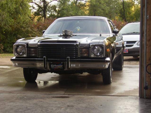

tunnel ram will work with a 6 pack scoop but you can not run air cleaners. I have a 5'' scoop on my R/T. mine has seen 130 mph in the 1/4 and no issues with it wanting to come off.

perfect pic for you to see the height with air cleaners
