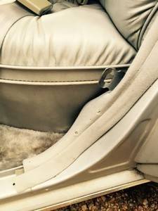

Recovered the trim on the interior since most of it was disintegrated. Looking fine. Right up until I installed the back seats back in to the car and I scraped the trim on the driver's rear side.
Notice those two fine looking holes in my recently recovered trim.
I should have covered it with a towel, painter's tape, an old shirt -- something.

Yep. Never fails.
But consider it that one ouch you were dreading out of the way.
Still looks great.

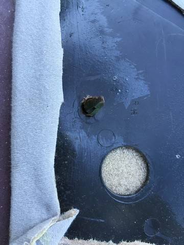

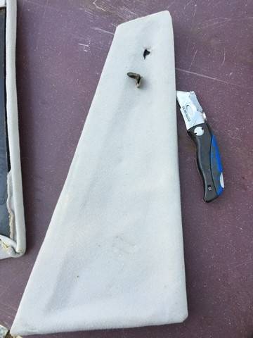

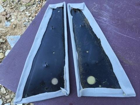

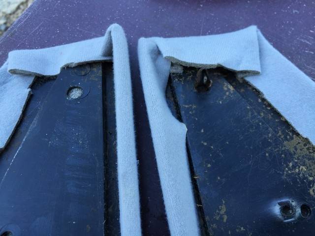

These two pieces are what the triangle pillows sit it. This is the backside. These should be symmetrical. They are not. Look closely:
Why did I leave that press fitting in there? That is supposed to be on the back of the pillow.
And by golly, I did it again on the upper part on the other side.
Get your box cutter and longnose pliers and remove the press fittings.
After I removed the press fittings, I put them on the back of the pillows like they should have been.
I poked two holes through the trim pieces where the screws go so I could screw these pieces to the two metal brackets already in the window.
