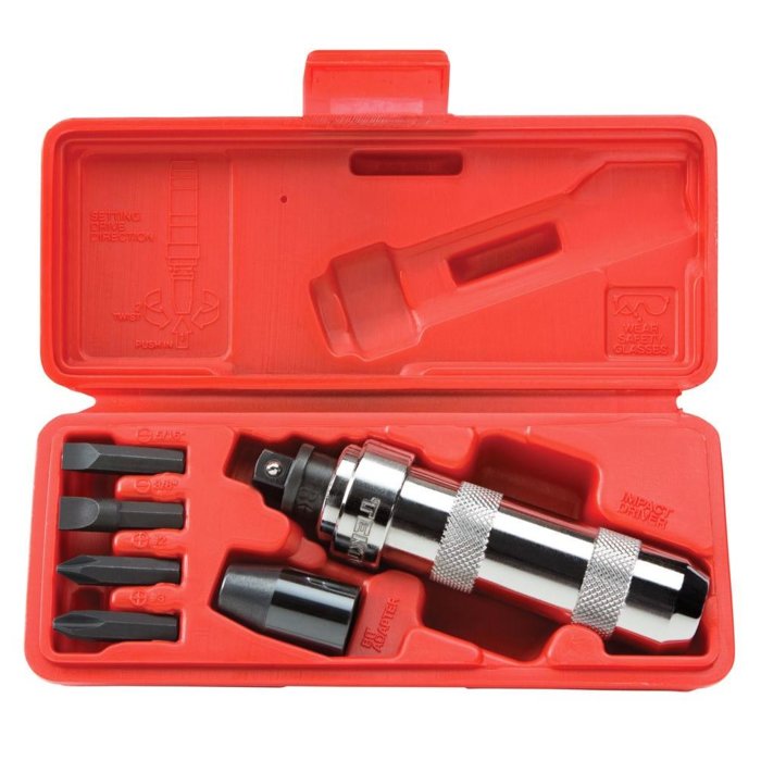

I recommend working on one door at a time. The #3 Phillips screws are not easy to remove – so using an impact screwdriver does help.

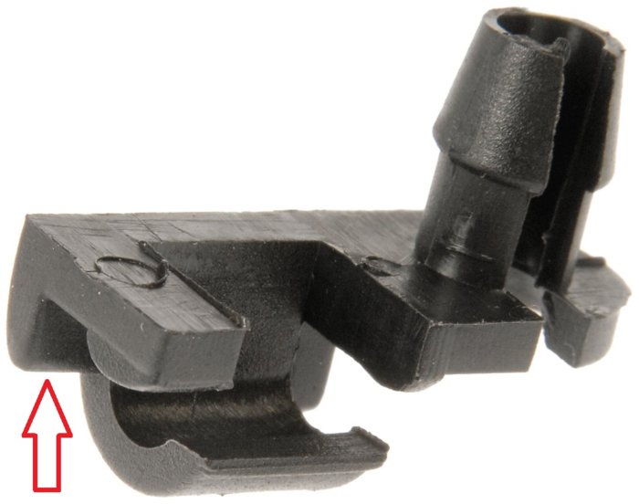

To disengage the clip, I like to take a stubby flat screwdriver and insert at location indicated by red arrow and the rod, and clip rotates away. Then pull the rod out. The clip typically stays with the latch – but can fall out (so watch out).

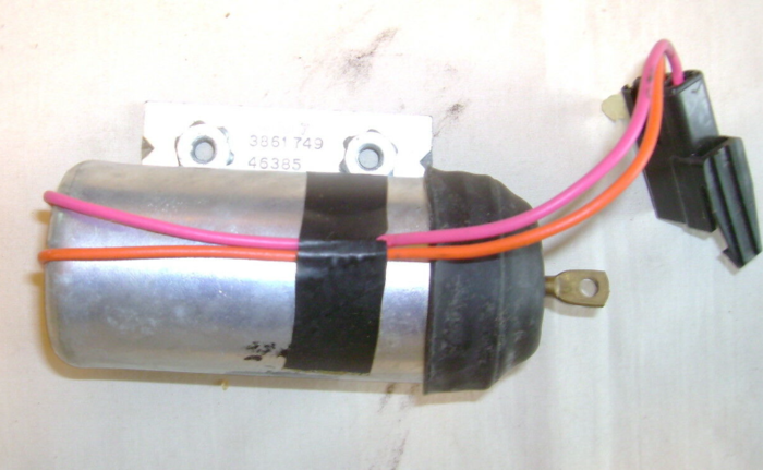

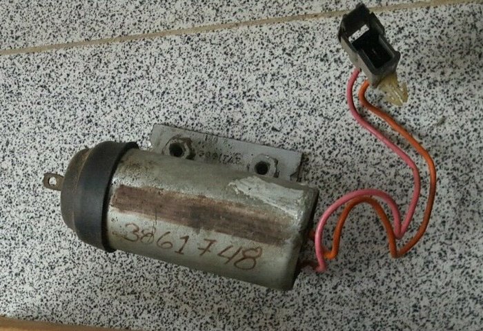

This is part number 3861748 (or 3861749, depending on side). These fit ’76-85 FMJ’s. It also fit ’77 B-bodies – so ’75-81 B/R-bodies might be a possibility. They might also fit other bodies, as well.
The ’86-89 M body uses 4396015 – which got superseded to 4467252.

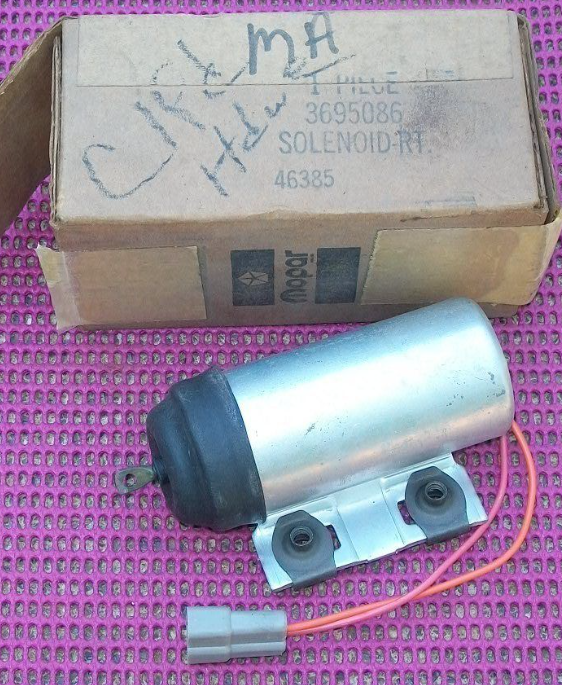

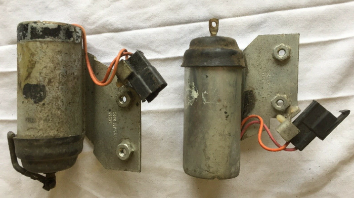

This is some actuators that are not a direct fit. I was just using them for example that you need to pay attention when looking for one. If desperate, a person could make these fit . . .
The electrical connector is different. This one "might" fit with wiring pigtail change (maybe).
These are from a C-body. Notice the shape/angle of bracket.

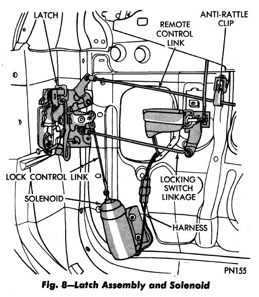

These are the directions for door latch and door lock actuator from my ’77 FSM (Factory Service Manual). This version, the power door lock switch is part of the lock knob (top of door panel). By pushing the lock knob down (or up) will lock the doors (or unlock). The M and J bodies use a separate door lock switch for this function.
