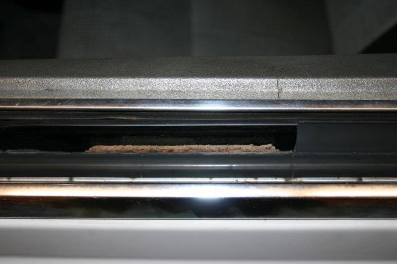

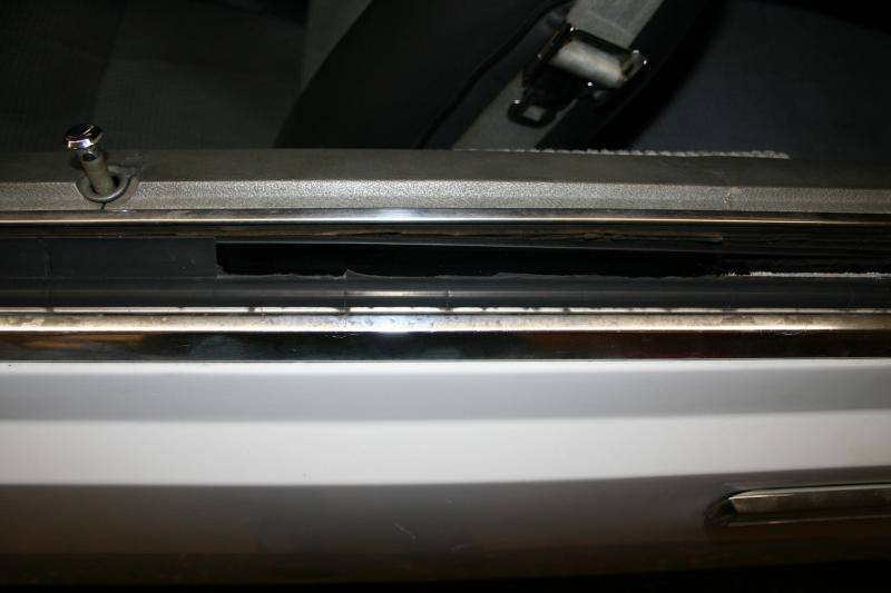

The door top weatherstrip stuff (whatever it's called) on my car is dry and cracked, and at least halfway completely gone. I've noticed a lot of other J-body (and probably F/M) cars have the same affliction.

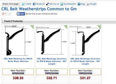

I found these at dk hardware that look like they could be made to work... definitely not an exact match, but maybe close enough.
http://www.dkhardware.com/belt-weatherstrips-common-to-gm_ZC546M0P1.html
I don't really care if it looks original or not, just so it seals up the door better and looks better than dried up junk.
Anyone try these strips, or have some other solution? (Preferably something cheaper, as this would cost around $80 + shipping for enough to do one car, but I could live with that if it looked good and there wasn't a better option).

Okay, now that I have that out of my system on to the parts. I actually ordered one of each of the 3 types. I don't have time right now to pull the door apart but looking at the 2 with the metal reinforcement I think there may be some potential here. Will post some pics when I get the door apart and see what can be done.

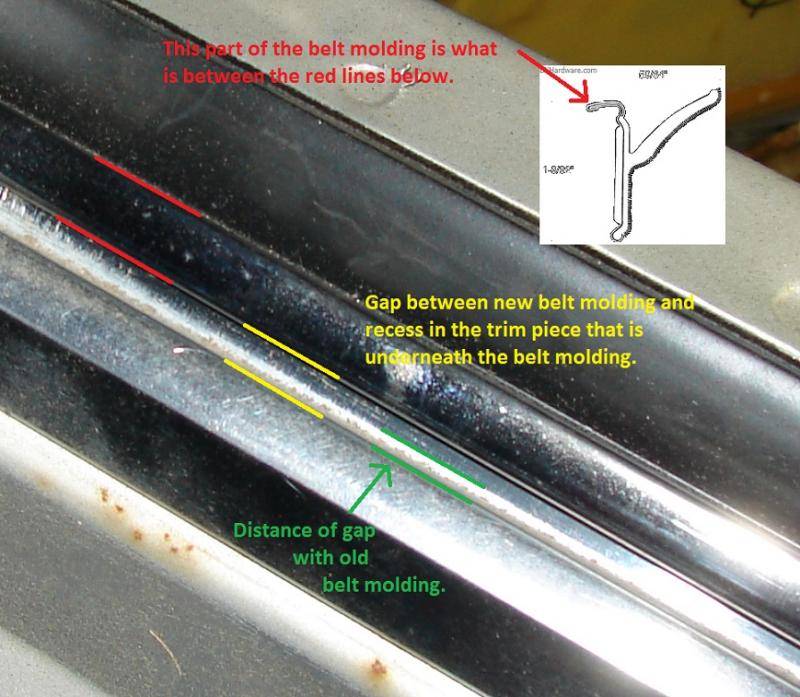

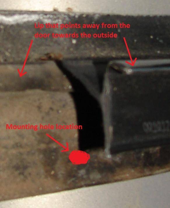

Okay, before I went to bed last night I was able to sneak away and play with the Imperial while the wife made dinner. It helped that her van needed an oil change so while the oil was draining I took the driver's door on the Imperial apart.
And the answer to the question of the day is: yes it could be made to work but as a last resort. The biggest problem is the backbone/spine of the belt molding is not tall enough (as seen in the first pic). It barely comes down to the top part of the mounting hole locations and there's not much room left to drill higher mounting holes in the door panel. Second item is the medal lip that points away from the glass. It's not as wide as the old one so there is a larger gap in the recess for it (as seen in pic 2).
Found another thread about this and think I will just buy a set from them instead of trying to make the one in the pics above work.

Cool, thank you very much for checking that out. For the about $70 they would cost, I may end up just using those anyway, instead of spending over $200 on the ones from restoration specialties. I doubt if my car will ever see rain, and I'm trying to spend as little as possible since these cars tend to not be worth squat.
I can't quite tell for sure which one you are showing there... is it part # YMR256X96 or YMR255X96 from dkhardware?

I believe it was the 255. Will have to check later on to be sure. I tried to get a pic of the two side by side but it didn't come out to well. I think the only real difference between the two is the spot where the rubber attaches to the spine is a little lower on the 256.
If you still want to go this route I would be willing to sell you both the 255 and 256 for $40 plus shipping (I still have the 8 foot tube they came in).
