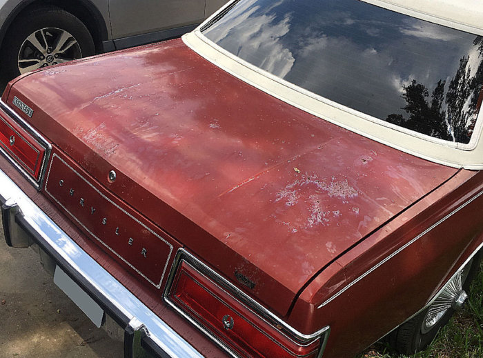

People have been mentioning bare metal and how to address it. Of course, there are going to be 2,342,782 different "right ways" to do it. I have a way that has worked for me for years.
My 78 has the original paint, but rain dripped onto it and got through the paint. This paint may look good, but it's over 40 years old, a fart can go right through it. I took the deck lid off as that's by far the worst. I am doing the whole car, but the booth is full right now. I have to move a lot of stuff around to get to it. If the color is a mile off I will know right away.
This is it.
As is always the case, it's a lot worse than it looks.

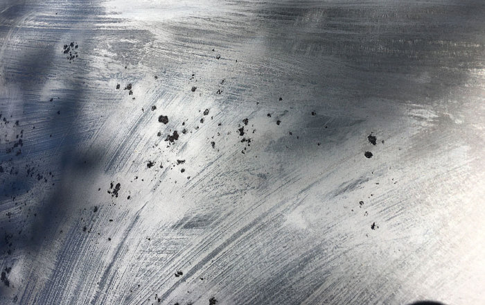

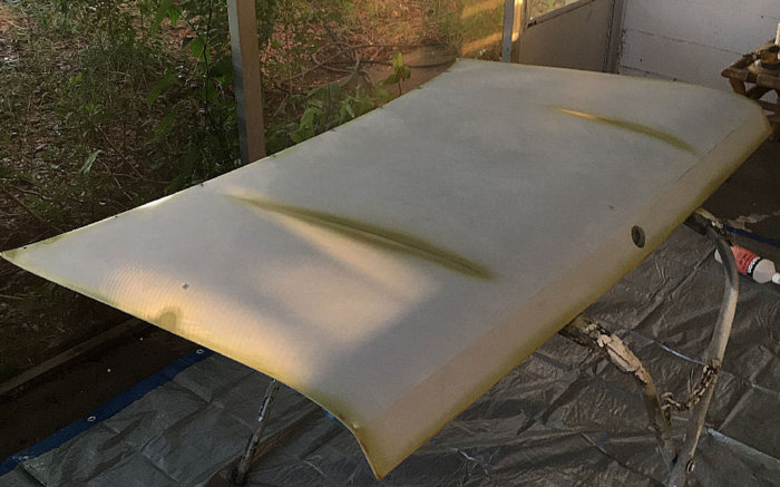

These pictures were taken after stripping and Ospho. The Ospho was allowed to completely harden, then the decklid was DA'd with 80 grit and it got two coats of Axalta Variprime Etching primer 617
The etching primer was allowed to flash about 45-50 minutes. High humidity was why I waited so long here. In the booth, I would have cleaned the gun and put the primer right down, about 12 minutes. After 50 minutes, I gave it two coats of primer, and some black guide coat.

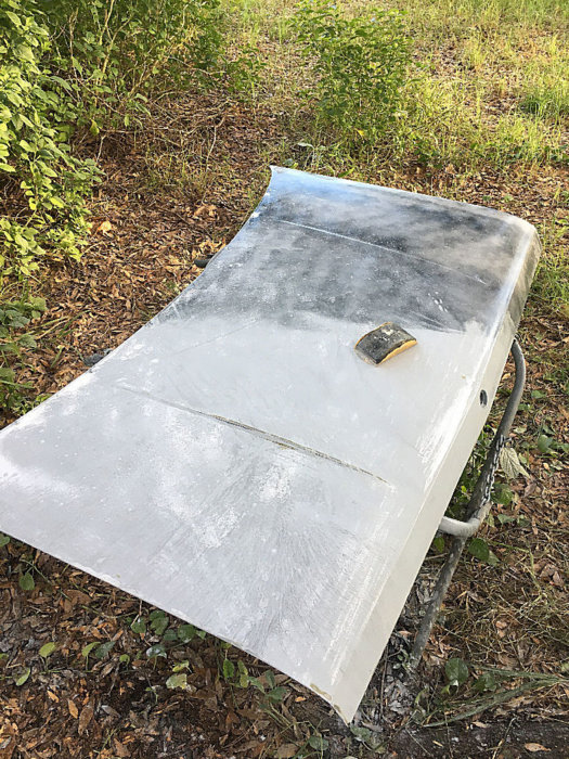

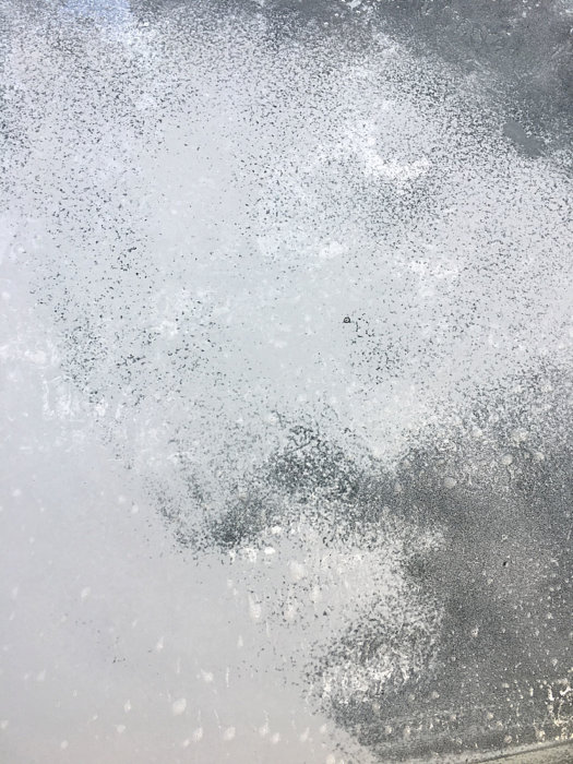

Block sanding sucks. If you like a car laser straight, suck it up and get used to lots of block sanding. This took 3 hours
The black shows imperfections and low spots. There aren't many as this car has never had body work or dents.

I used a touch-up gun to hit all the edges and cut-throughs with etching primer. I actually did the entire outer edge because it's easier than trying to spot every little minute area that I sanded through, there are a few but my eyes aren't that good. Easier to dust all the way around the whole thing. Any bare metal must be shot with the Variprime immediately. Leaving bare metal is a no-no, especially in Flo-Duh. Rust starts in under ten minutes.

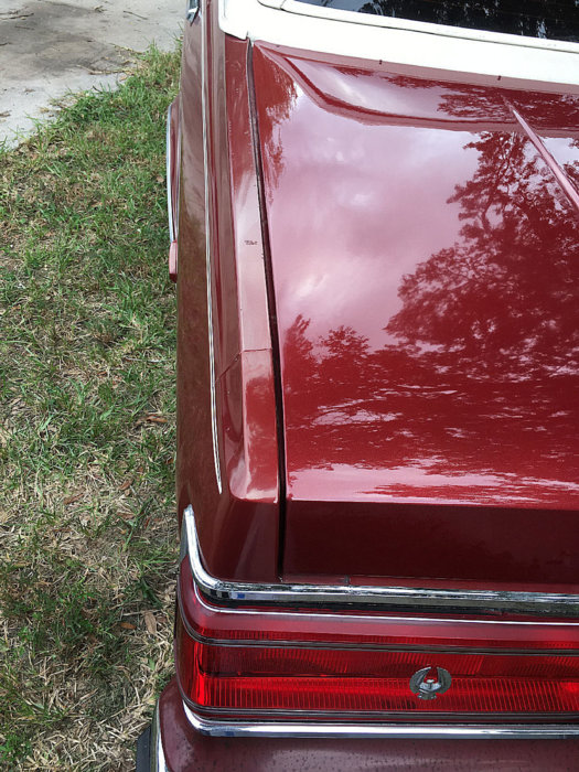

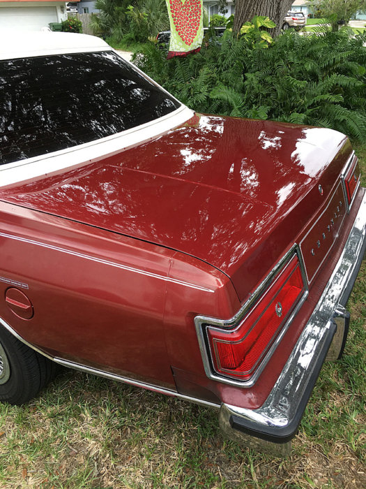

Got this done a few days ago. Good enough for me. Going to take the deck lid back off and do the rest of the car. Hopefully I can break every single moulding clip.
