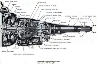

I need help with my buddies fifth avenue it has play in the drive shaft it doesn’t feel like the u joints the feel tight but it looks like there’s a carrier bearing that has play right past the trans but I can’t find it anywhere online. Please help me find the part or figure out what the problem is. Thanks guys

output shaft bearing in tail housing

best I can come up with is, part number, 4130537 and recommend to you call, A&A transmission to see what they have. Far as I know, they have more 727 and 904/998/999 hard parts than any other trans vendor.

Thank you very much sir, also is it a possibility that it could also be the slip yolk bushing

That's the most common. But maybe it's also one of those things that people don't replace the other bearing because it's more invasive.
