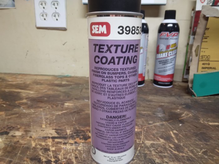

			It's tough to fix. I have removed and sanded the loose stuff off these and painted with SEM interior paint and they came out pretty decent. But if they are badly disintegrated they'll be too thin and warp after sanding.so on my lebaron ls the interior plastics are dry around the windshield what is the best way to fix these if possible
