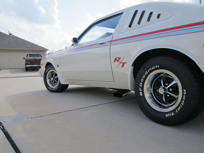

Anybody had any experience with any of the dual exhaust kits from Summit and Jeg's (Heartthrob) or Pypes etc. and an ability to modify any of their kits, like say an A-Body kit, into a J-Body?
I read the thread about moving the gas tank to fit in the dual exhaust, now I'd like to hear about some cool dual exhaust options y'all are runnin'.
247
Then check out this...
Mine is a h-pipe custom that exits both sides with some chrome ends. I am going to get it changed to both pipes exiting the passenger side rear near the rear bumper. I have that gas tank that is slid over towards the driver's side.

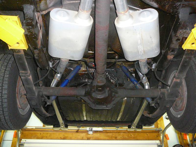

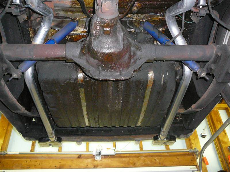

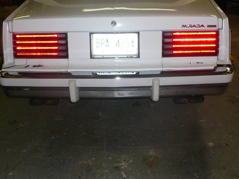

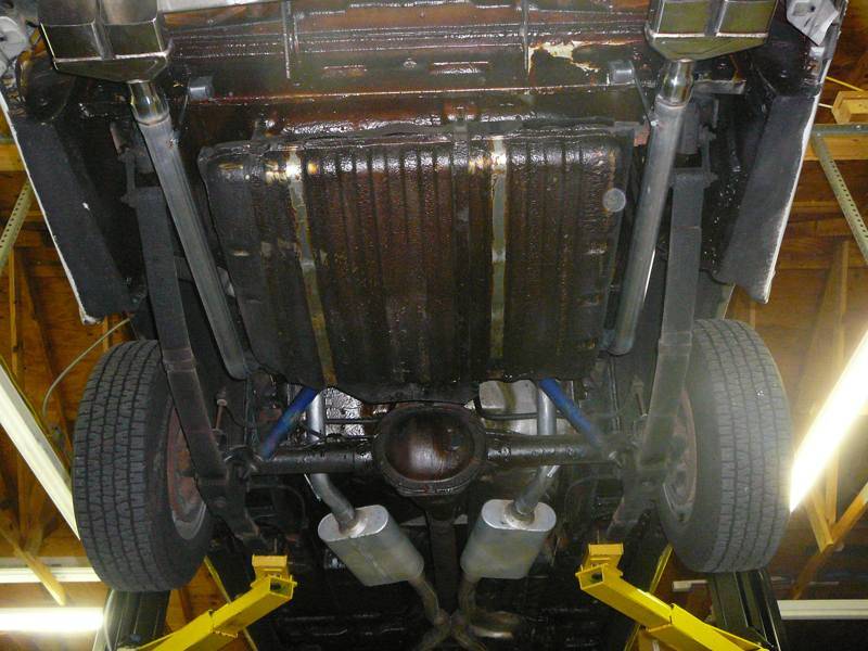

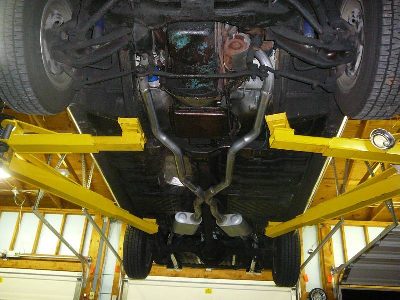

I had true duals run on my Mirada today. I moved the gas tank over one strap & the tailpipes exit under the bumper where they should. X-pipe with Flowmaster's, reproduction stainless tips for a Challenger. It turned out great!! Totally changed the car for the better.

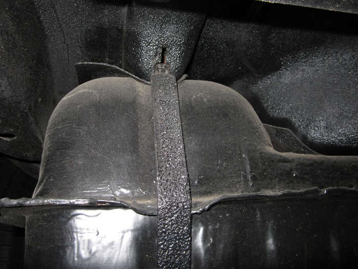

Yep it looks good. My gas tank has that huge hump up top..you guys run the later with no hump. That's why I say it won't happen. :director:

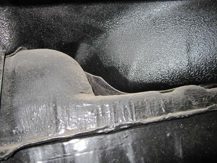

is this the bump your talkin about? if so mine fits fine and its in my 5th ave

The ('76-'77) f body tanks look like A body tanks and are kinda an L shape. F body don't have that bump either, otherwise they look pretty much the same. ('78-'80)
247
This is the L shape Ross was talking about...I call it a hump. It would hit the spare tire tub if you tried to move it over.

Hey CMX, is that "trans fluid" blowing back covering your differential and tank? Looks like something is leaking:(
I'm not saying there's no oil leaks, but what your're seeing all over everything is aftermarket rustproofing that was applied when the car was new. It's greasy oilly shit that never dries. It makes working on anything under the car a sticky mess. In the summer heat, the stuff actually starts to drip off the areas in proximity to the exhaust & onto the garage floor. Turbulant air movement & road spray from driving down the road actually cause dust size particles to settle on the back of the car, & normal washing won't remove it. Every time I wash the car I have to go over it a second time with a degreaser to really get it clean.
I understand why the stuff was applied when the car was new. The car was sold new in Detroit, but wound up being parked most of it's life & saw little or no time driving in road salt. It's just messy & unattractive. I sometimes think about removing all of it. However, this is my daily driver & what it looks like under the car isn't that important to me.

That looks real good, thanks for the excellent pics.
Nice to know the A-Body kit is an option too Fellas, thanks.
How's that baby sound now CMX?
I think it sounds great! It was way too quite before. With THREE catalytic converters & a muffler, it was difficult to tell if it was running while idling. I like the looks & sound of duals, so even though it was expensive, it was a must have for me.
