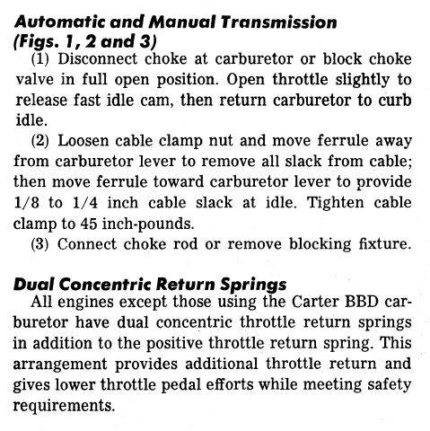

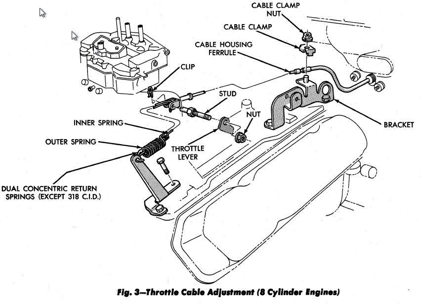

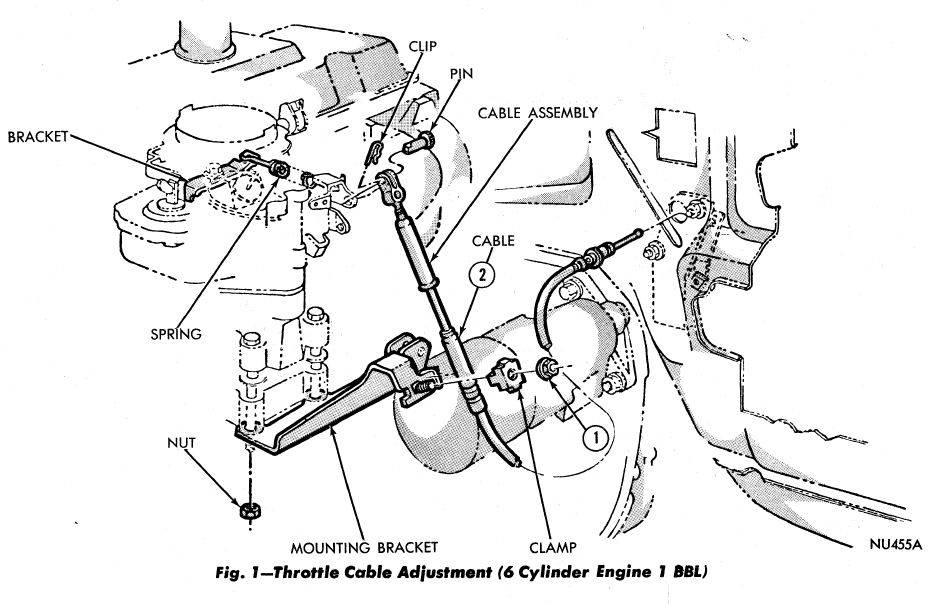

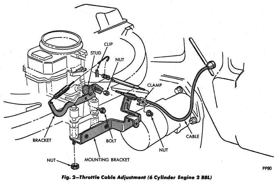

The official throttle cable adjust procedure.

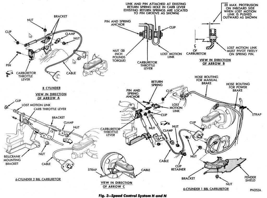

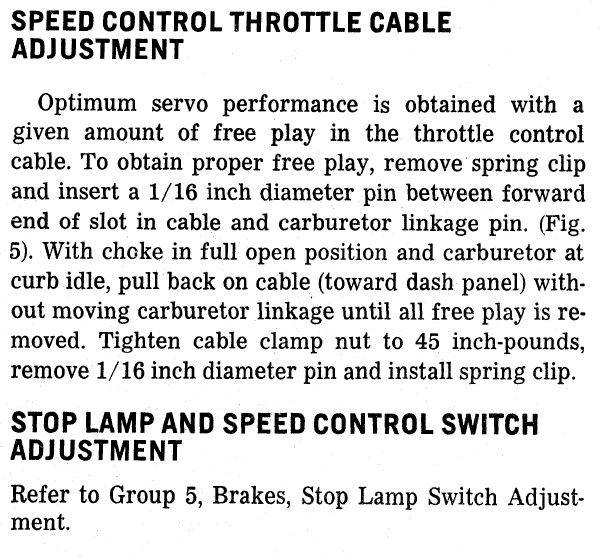

The official cruise cable adjustment procedures.

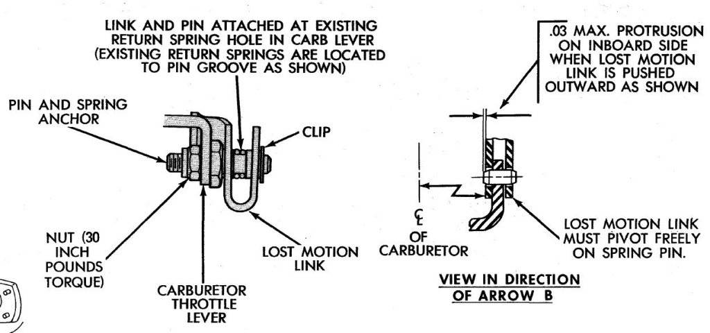

A closeup of above picture

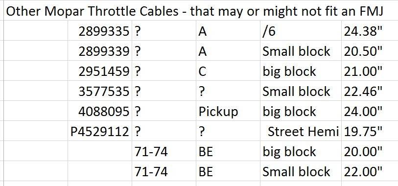

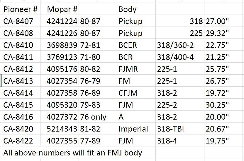

I dug up my Throttle Cable file (attached below).
I’ve always known that 2-bbl and 4-bbl throttle cables were different – by an inch or two. The same should apply to FMJ bodies as well.
My records show a FMJ 318/360 2-bbl cable to be 19.72 inches long.
Records also show FMJ 318/360 4-bbl cable to be 19.75 inches long.
I said that can’t be correct so went and looked in my books and that is what they say.
I don’t know why they would have two different part numbers for “adjustable” cables that are 0.03” different in length – so I think my books have a typo in them (makes no sense to me).
In my garage (somewhere) is a used ’84 Gran Fury 318 4-bbl cable. I’ll try to locate, measure and report back.
My records
Note: the Pioneer cables listed above are all available as of September 2016.
