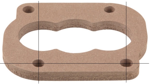

The Imperial 318 TBI intake is also the same intake used on Dodge pickup TBI engines (pre-Magnum), and uses an odd staggered-bolt (not squared) throttle body.

i dont think i am smart enough to do the TBI, and i have a dist, carb, gaskets n some help. i just need the manifold. yards are 3hrs away each way so if i can get one shipped to me thats a big deal tks and being color blind doesen't help
