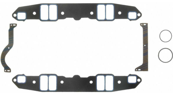

4. They make intake gaskets with the exhaust crossover ports not made into them (for racing) – but not for a car to be driven on the street. I do recommend the exhaust heating the intake for better driviblity. The problem with this method is you still have to man-handle that cast iron intake (like option 2).

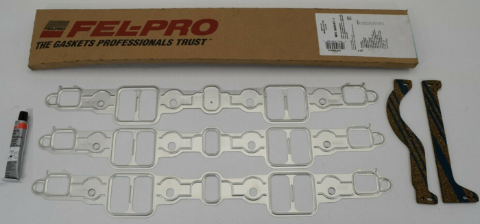

A normal 318 gasket set (but I hadn't ran across this one, with the third gasket, yet).
No exhaust crossover.
