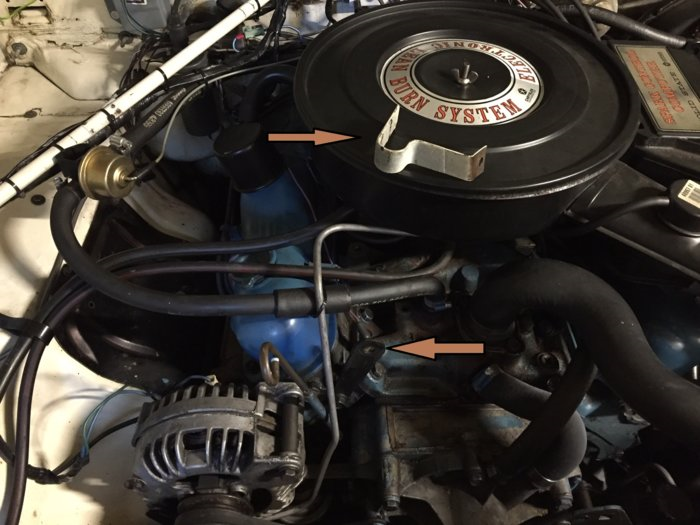

So I think the heater hose bracket you are talking about is the one on the picture that was originally mounted on the A/C compressor. Thats why I re-routed one of the heater hoses to go straight over the engine and into the firewall. Maybe this is a bad place for it to be ?

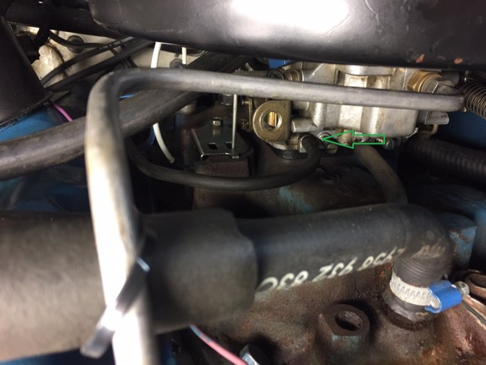

The shop has put the vacuum advance hose on the front of the carb (green arrow), and you say it belongs on the side where the port is currently blocked off.
I will try moving the hose to the port you suggested, but can you understand I´m a bit confused at this point :)

Any interference (or possible interference) of the throttle cable and/or kickdown linkage always ends up with bad consequences. I do agree with AJ/FormS that heater hose(s) need to be far away from where it is currently located at. Hopefully my pictures are helpful.
I do believe your current Holley 2280 is for/from a computer-controlled spark (ignition only) system, because of an additional gold colored bracket at Passenger Front lower corner of carburetor. There was a throttle position sensor located there, that was removed (except for its bracket). I would agree with AJ/FormS that computer-controlled cars didn’t have the nipple/port for vacuum advance (only a very small percentage did, but those are RARE). That said, many of the factory replacement carburetors did have the port/nipple present so one replacement part would fit many cars. I believe your carburetor is a factory replacement carburetor (sold after ’84, after Carter carburetor went bankrupt) that was made to fit either computer-controlled or non-computer-controlled cars – but either way it is not worth arguing about.
All 318 2-bbl carburetors (that have vacuum advance) has the vacuum port at the location indicated in my picture, regardless if it was a Carter BBD, Holley 2280, Bendix/Stromberg WW3 or a Rochester 2GV (the last two were not used on FMJ’s). 4-bbls and 2-bbls used on other Chrysler engines will differ on the site of port.
Another thing to look at, Chrysler vacuum advances uses vacuum from the venturi (vacuum only when enough air flow is through the venturi). The vacuum port you have listed would be manifold vacuum (at base of carburetor) so this would have vacuum full time (except when under power).
I do not recall ever seeing a bracket that looks like this one, before (top arrow). I can’t see what the bottom arrow is pointing at to comment about it.

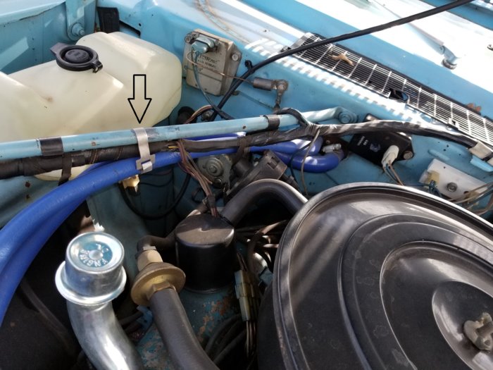

Normally Chrysler routes the heater hoses above the metal fuel line, but i wouldn't worry about changing it.
Chrysler used one or two aluminum tie straps to hold the heater hoses onto the fender brace. Zip ties will work as well.

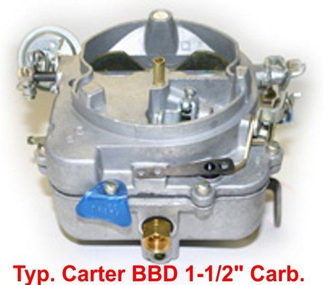

Of the Carter BBD’s, there are two different sizes and two different versions.
The size we use is the smaller one (1¼”). The bigger BBD (1½”) is about 50% larger overall and won’t even bolt up to a 318 intake manifold (used for 360, 383 and 400 2-bbl engines).

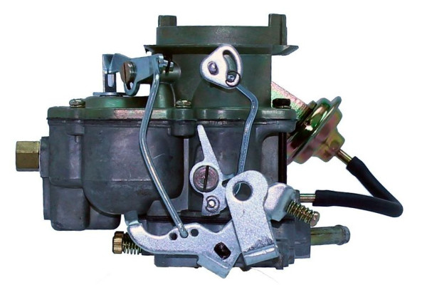

Of the 1¼” size, there is the older low-top version and the newer high-top version
Low-top (1966-73)
High-top (which is the one you are looking for – 1974-’84).
Of the high-top version, the ‘80’s versions were mostly computer controlled. If you see any electrical wiring or connectors in pictures – stay away from it. All the non-computer controlled high-top versions will work fine for your car. The low-top versions will work as well but look funny and there is no provision for fuel vapor recovery (which is needed in some emission control states, cities or country’s).

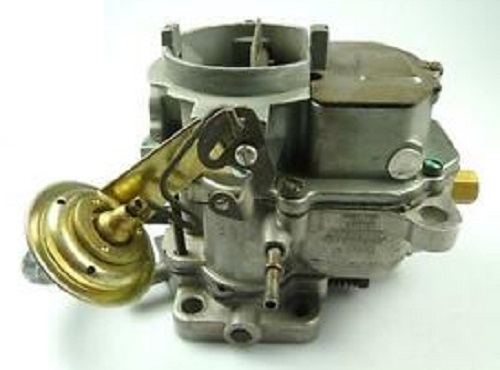

Here is a high-top version I found on eBay (and there is a ton more out there to chose from).
2 Barrel Carter BBD Carburetor Carb For Dodge Chrysler 318 Engine 5.2L 603894987695 | eBay
There are even some NOS new Carters available there for sale as well, but they are $$$. I don’t think you can go wrong with an aftermarket new carburetor (in my opinion).
If you find one and have questions, post a link here and I can (or others) can comment.
