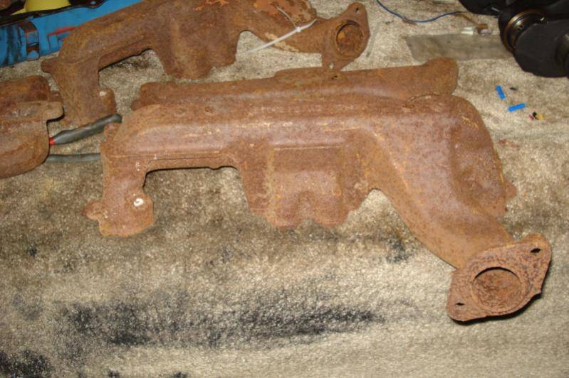

Do you think this 340 hp exhaust manifold would work on an M body without any issues. The dump seems kinda long compared to regular 318 and 360 manifolds and I wonder if it would clear everything.

I had a set of those on my F-body with a 360 and power steering They cleared fine.

I was thinking I tried a set of those once an had issues with the brake booster? Dunno it's been a long time....

You could be right. I had manual brakes on mine.

The only problem I see is the cash needed for the heat shield/gasket for the driver's side. Take them to a machine shop for shot peening or have them sand blasted then coat them with Por 15 high heat exhaust manifold paint. Just like mine.
