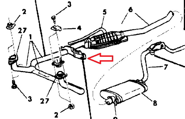

Something seems to be holding the Y-pipe in place.
The bracket (red arrow) attaches to the transmission. The two exhaust manifold flanges and this transmission bracket makes the front part of exhaust pretty stable.

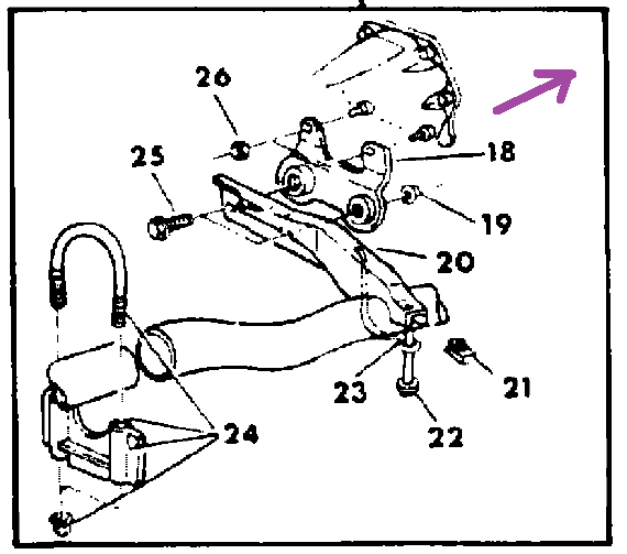

A closeup of the transmission bracket. The purple arrow is pointing towards front of vehicle.
Some FMJ's have the exhaust bracket attach to the transmission mount and not to the transmission extension housing, like your car has.
If your didn't have the rear cat on car, you can do away with the transmission exhaust bracket.
Without that transmission bracket and with cat in place, you will experience cracks in the exhaust pipe due to the extra weight.

BudW Thank you, I unbolted the hanger, but will remove the bracket. You sure are right about the pipe being stable. Hardly think they needed to fasten them at the manifold. I note your post to Just Wondering about going to a muffler shop. Problem is, the car is torn down and not running... I sure hope this works, and really appreciate your detailed help!
