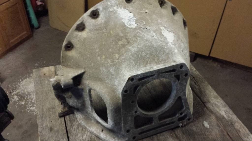

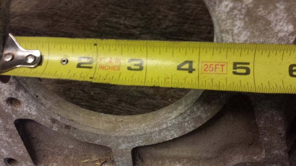

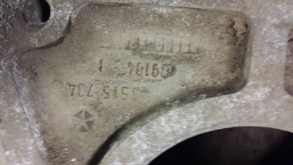

- I will check into the retainer hole and see where I'm at with the bellhousing I have. It's a little rough from sitting in uncles barn but should clean up. Some aluminum was flaking off of it. Should I put some sort of scatter shield in or is that only for high hp applications?

Looks like that bell fits the non-od trannys. While a scatter-shield is always a good idea; For a low-perf streeter, my opinion is; if you are not doing neutral drops at peak torque(who does that on the street?), it might be more than you need. I have been driving stick since 1970, and have always had the stock bells and flywheels. That makes 45 years. My flywheel has about 8 runs on it,with about 4 of them neutral drops.And over 100,000 miles. Am I lucky? IDK, blessed maybe. But I have never met a one-footed Mopar man, nor heard of one, so that's my useless 2cents.
If the block has never been line honed, there is a real good chance that the retainer hole will be really close. But it should still be checked, and relocated as may be necessary. If it is assembled out of spec.;tranny life may be shortened,gear-whine is very likely, but more importantly, the pilot bearing may have a very short life.
Check that crusty bell over very closely for cracks.
