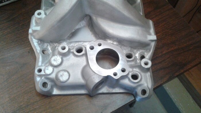

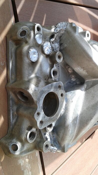

This won't be for everyone but I did a cut and splice with a torquer ll and a performer rpm. My intention was to maintain a stock appearance.
