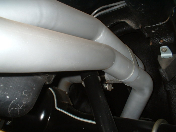

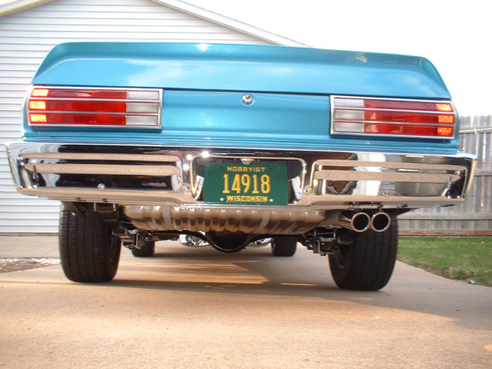

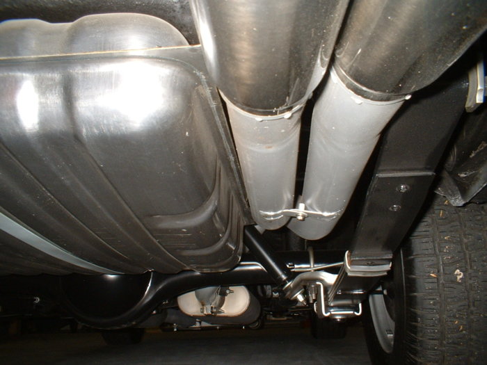

Yes they did. The tailpipes were kind of a let down though. They ran both together over the rear axle to a "Y", through a resonator and then had only one pipe exiting the rear. Kind of ruins the effect, lol.
I did something similar on my car except instead of making a "Y" tailpipe, I ran both all the way out the back on the passenger side.

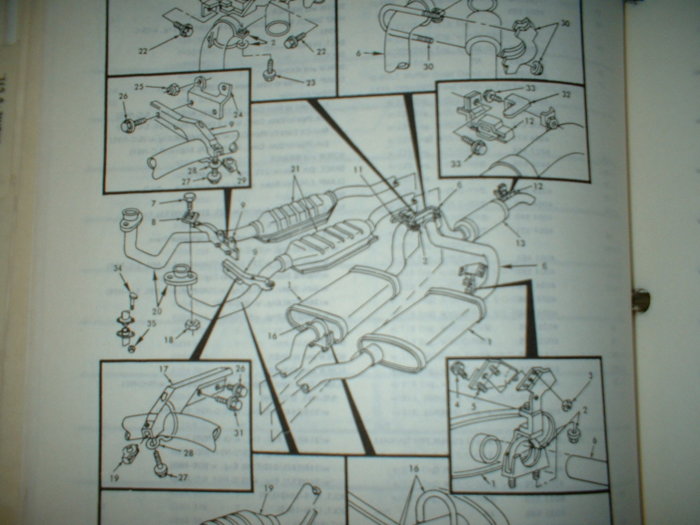

A photo of the '79 parts catalog page showing the pieces for E58 360.

I have an old car mag somewhere that shows that exhaust system. I'm really a sticler for original but will duplicate mother nature with 2 1/4" back to mufflers and 2 1/2" y pipe/tailpipe. -no cat's

Actually the article showed normal dual exhaust back to mufflers but in front of gas tank the drivers side goes over to splice into single tailpipe
