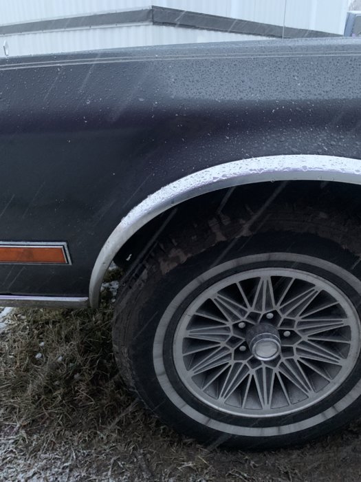

    Not to shure on the 235/75’s but I have 225/70/15’s on all 4corners and on the front they BARELY clear when backing up

    A 225/70 is roughly 3/8" taller (and a hair wider) than a 205/75-15 at about 27.4" dia which is 1 1/2" shorter than a 235/75 so, if the 225/70's almost rub.................

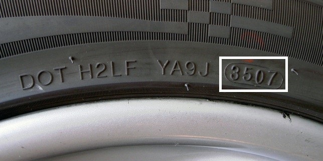

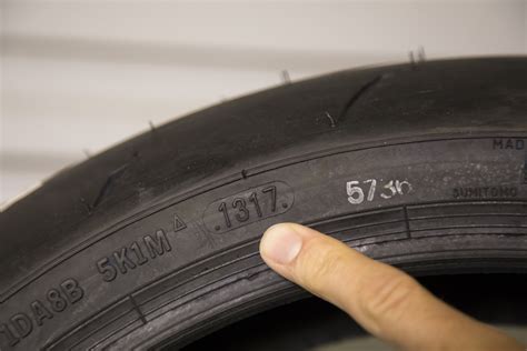

    What I do want to comment about is be sure to look at the tire manufacture date – which is stamped onto one side of the tire (inside or outside). If tire was made after 2000, it will have 4 digits stamped into tire, just after the DOT number.
    Examples:
    35th week of 2007 (WHICH ARE TOO OLD)!
    13th week of 2017 (these would be good to go).
    Tires are not safe to drive on after they are 10 years old (or 7 years in hot areas like Phoenix). Look at that tire stamp before purchasing! I wouldn’t purchase them if they are 8-9 years old (unless you are looking for the wheels, as well) – unless they were a steal.
    Most of the tires I see for sale at a bargain are typically not safe to drive on.

    This is how the 225/70/15’s look on my 84 5th ave
