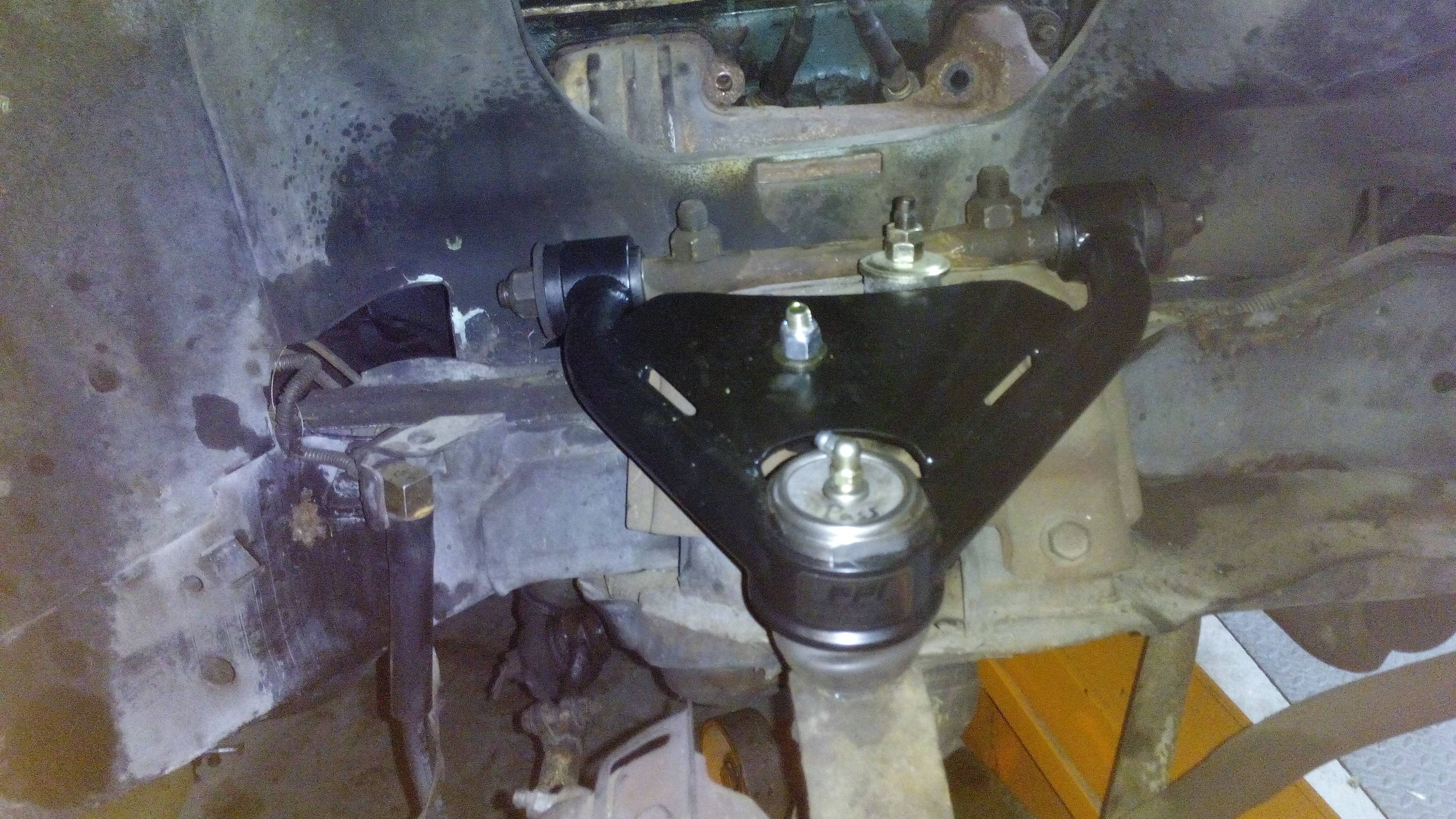

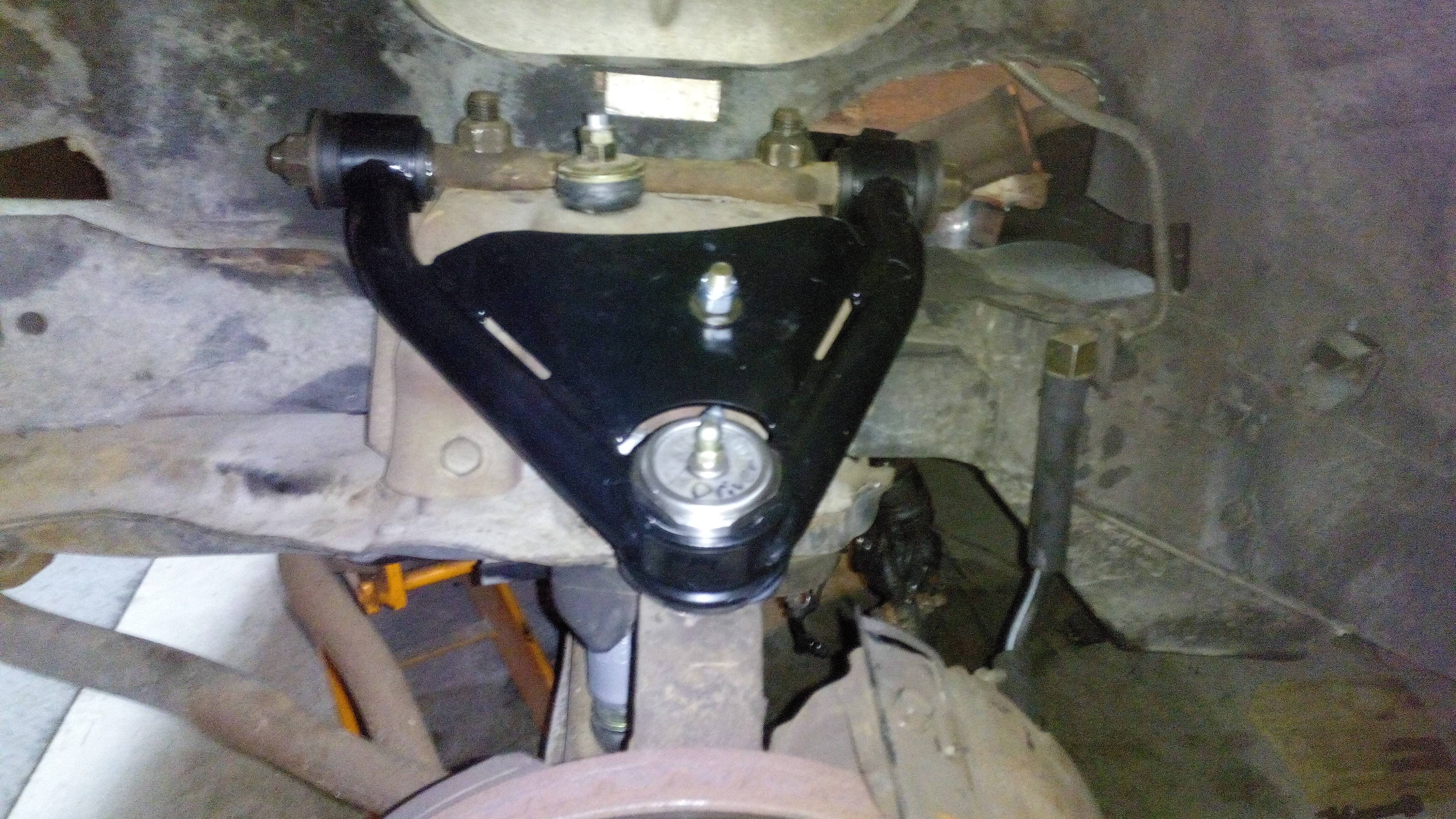

Tonight I finished installing the ff UCA, very easy and straight forward, takes about 30 mins a side. Longest part of the job is getting the pivot bar out the old UCA. Many thanks to Dennis at ff, real helpful!!
Next the alloy body mounts to go in, anyone got any tips?
