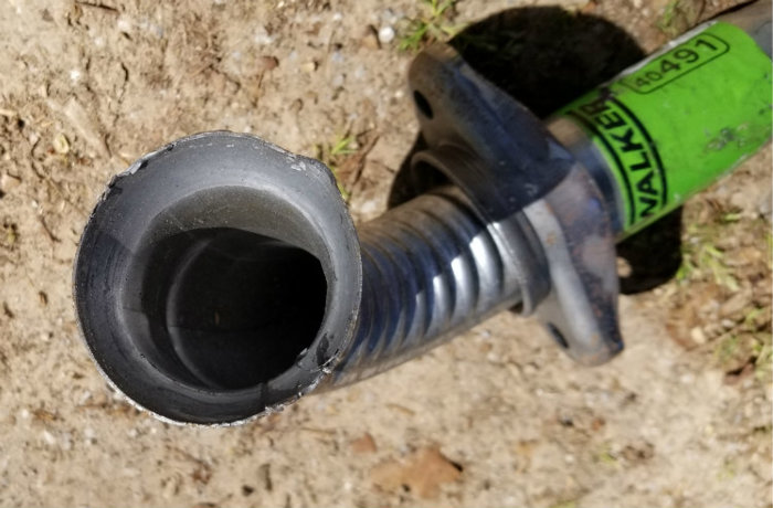

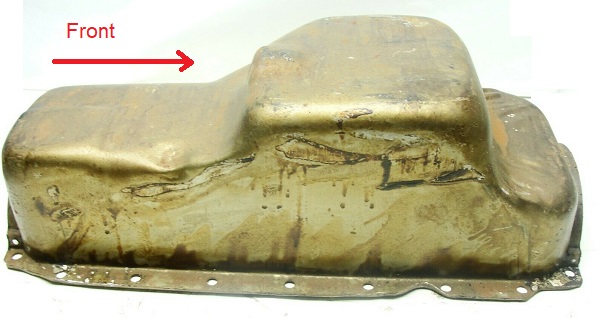

Before I ordered, I saw it fit Plymouth and didn’t think about nor investigate it more. The Plymouth versions this part does fit is the pickup/Ramcharger versions that Plymouth made for a couple of years. I would agree, it is for pickups and it shouldn’t fit FMJ’s.

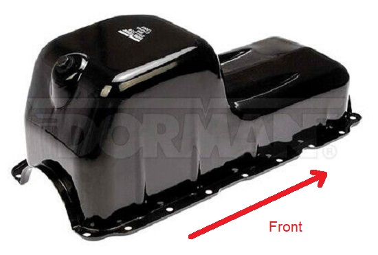

The pickups have the oil pan sump in rear part of oil pan where as FMJ’s (or Chrysler cars, in general) are in mid-section of oil pan.
318 pickup (early '90's version shown)
318 car pan

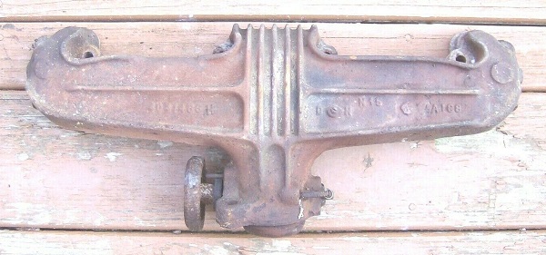

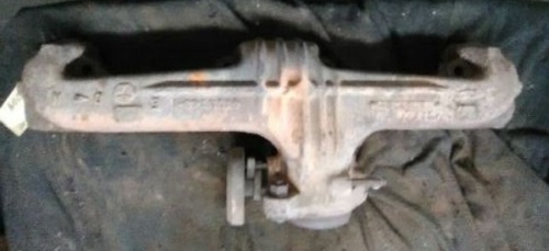

Also, pickups use an identical appearing exhaust manifolds for small blocks for both sides (center dump).

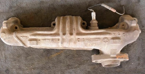

FMJ’s use a rear outlet exhaust manifold on drivers’ side, to clear the steering gear.
My ’77 wagon does use a pickup style center dump manifold on passenger side of car (as shown above).
My ’86 Fifth Ave uses a slightly offset center dump manifold on passenger side, so because of this, there is a difference between the early and later FMJ Y-pipes (if one wasn’t to account for the difference for the pre-catalytic converters on the “non-Canadian” Y-pipes).

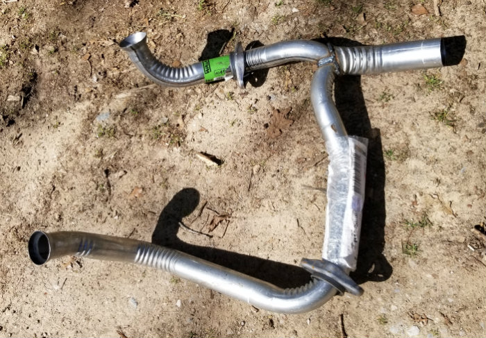

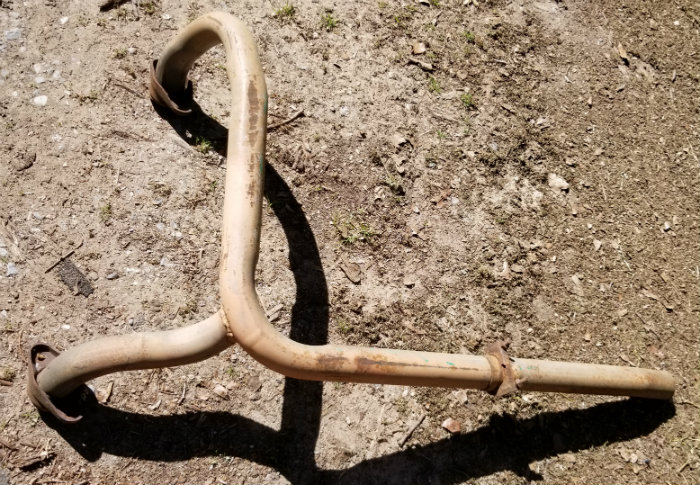

Going by memory (which can be a not-so-good idea), I recall there is seven different Y-pipes used for FMJ's in US/Canada (and maybe more?):
- 360 (single exhaust (front half))/318 police without pre-cats.
- '70's 360 with almost dual exhaust the (Y-pipe is by the differential)
- 318 police with 2 pre-cats
- 318 (non-police) with 2 pre-cats.
- 318 (non-police with 1 pre-cat.
- Two different versions (pipe size) of 318 without pre-cats.
The term “pre-cat” refers to the catalytic converters a short distance from exhaust manifold(s). Almost all (not quite all) FMJ's came from factory with a catalytic converter underneath the passenger side front seat – so when the term catalytic converter is used – it is always referring to the one under the seat. Pre-cat is always referred to the ones by the exhaust manifolds.
This Y is from a '84 Gran Fury police car and was original. The exit pipe size is 2¼” on this pipe.
I had to cut off manifold flange ends because the nuts were rounded off. With those pre-cats so close to the exhaust manifold fasteners – it can be a bear to do, even if rust wasn't a concern.
Also, this Y weights a good 3-4 times more than the Y, below.
This is a Y from a '80 Aspen wagon 318 2-bbl. The exit pipe size is 2”.
It looks exactly like the Y from my '77 wagon 318 2-bbl – but its exit pipe size is 2½”.
Unrelated, this is the pickup Y-pipe mentioned earlier in this thread – and you can see how it is bent a lot differently (because of the engine oil pan).

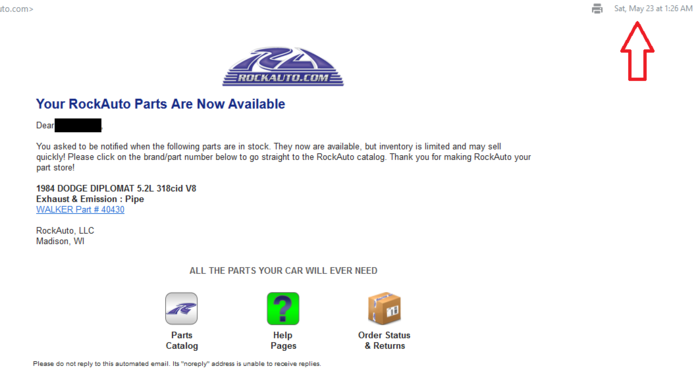

I got an email a few moments ago:
Save one for me - I get paid (next) Friday . . .
Edit, I click on the link, and guess what (sigh), they are out of stock. Maybe website is out of date?

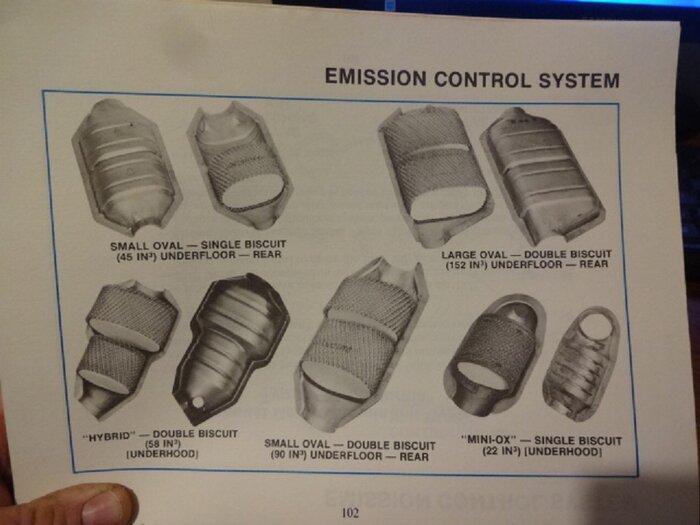

Under Floor and Under Hood were the two terms used on the cats. Dont look to be like pre cats, look to be like mini cats from the guts.
1,494
They are mini, they are underhood and definitely are catalytic converters.
It is a term we always used (as well as "post cat") when in the shop when they came out - and it stuck with me.
Who has the time to measure now many ci (IN3) a cat has?

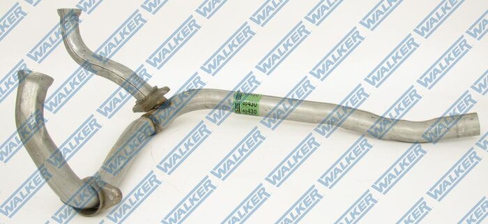

Do these 40430 pipes fit 1980 Mirada too? I half ass thought about redoing the single exhaust in a 2.5 inch for now, until I pull the engine for a refresh and add headers. It'd be nice to find one...I could do the single exhaust in my friends garage....
