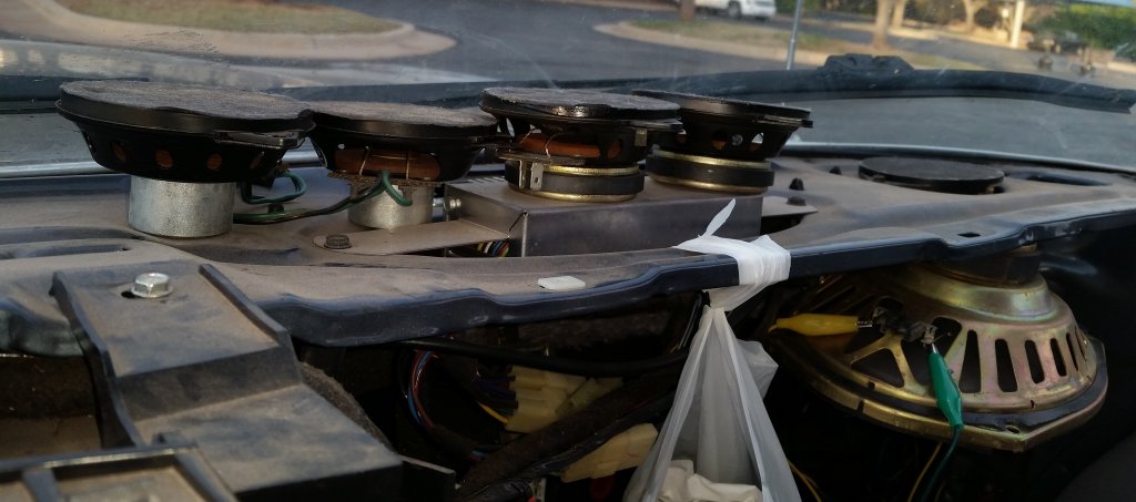

I need to replace both of my dash speakers.
A few of them has been purchased off of eBay with mixed results (bad, or same condition my old speakers are in) and even purchased 4 from a pull-a-part close to me not long ago (3 of 4 were bad).
Holes will not be cut in door panels nor anywhere else, except maybe possibly to make the dash holes slightly bigger if needed.
I mostly listen to AM – so sound quality doesn’t need to high - just as long I don’t get buzzing, rattling and/or “nuttin”.
Has anyone found a good source for speakers for new (or maybe rebuilt)?
(or anyone NOT to call)?
Finding used speakers has gotten me nowhere and good luck finding NOx (sic).
My ’86 5th Ave is a 4 speaker car (my main driver). The two Volare’s are single speaker cars, but will be converted to 4 speakers when time comes (and one of them is blown, as well).

Here's a great thread on replacing your Fifth Ave speakers.
6 X 9 speaker install in the rear parcel shelf
I wouldn't even waste my time with used. The paper cones will never be any good.
That threads explains everything including being aware that the magnets in the 3.5" ones in the front have to be shallow enough.
As far as the Volare's they are 4x10's.
I'll dig up the link I have for new full range replacements.

I'm pretty sure these are the winners. But any good 4x10 will work.
RetroSound D-412UK Dash Speaker

Just curious, what all was entailed to pull the dash off to get to those speakers. I have a center 4x10, going to swap out with 2 3.5" Pioneers in an adapter. Looking at the car today, I wasn't sure how to get to that speaker :eek: any help much appreciated.

Once you have the 4x10 speaker out, trace it on some sheet steel (or plastic) and cut out using tin snips (or whatever).
Then cut a pair of round holes in it and bolt speakers into that.
I would recommend painting your newly fab’ed bracket black so it doesn’t show via the top plate speaker grate).
The top plate fits all F & M bodies (not sure about J’s) so a person might be able to find a stereo top plate the same color (or paint one to match) fairly easily – if one wanted to go that route.
