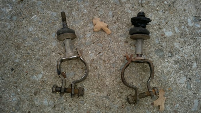

Also, the middle two bushings have a larger inner diameter and a smaller outer diameter, which means the brackets that attach to the K-frame are also different (from non-police versions).
These are the non-police version.
