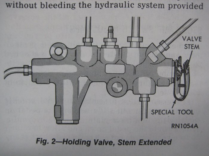

And the winner is ..... M_Body_Coupe - he suggested the 'Hold Off Valve' in the proportioning valve. (FSM, Chapter 5, page 5-3 - see pictures below)
I pulled out the FSM, read the write up about bleeding the brakes. Because I was on my own I had to make my own 'tool' using the taper on a set of needle nose pliers to hold the valve pin in position coupled with a small vise-grip to keep the needle nose jaws tight on the valve pin.
As soon as I pushed on the brake pedal I got significantly more travel and within a few pumps the pedal started to firm up. A quick check of both front brakes indicated that the each piston had taken up the gap between the pads and disk. Next test was to spin each wheel and see if the brakes would stop it - both worked. Neither of these tests had worked prior to today! Next I removed my 'tool' and tested again with the same results. I know I still have some air in the front system, when my better half arrives home over the weekend I'll do a proper bleed.
