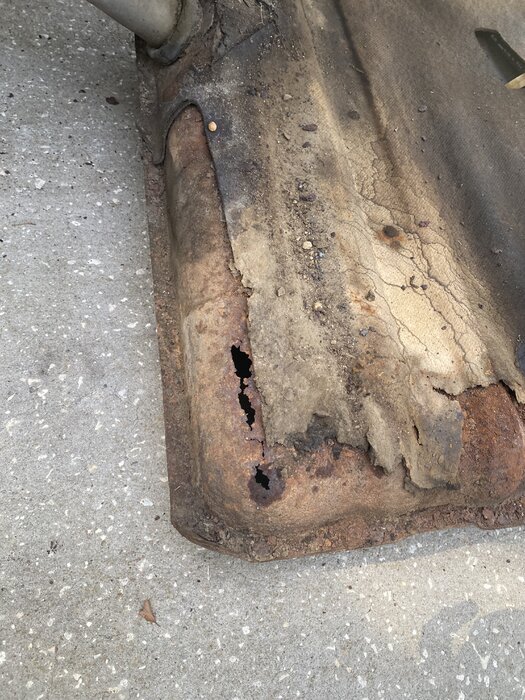

Thank you for the reply, I’m reasonably assured I found my fuel odor problem. Fuel tank had holes along the rear driver end. Tomorrow I’ll wire wheel the underside and coat it and should be ready to put all the new parts in by Monday.

That'll do it.
