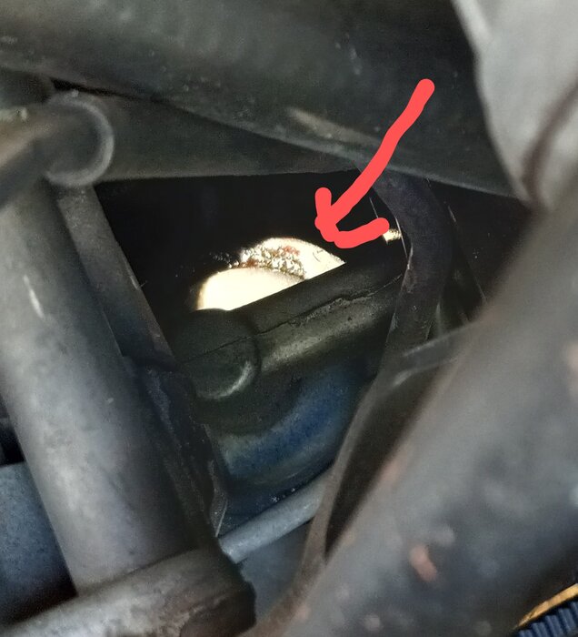

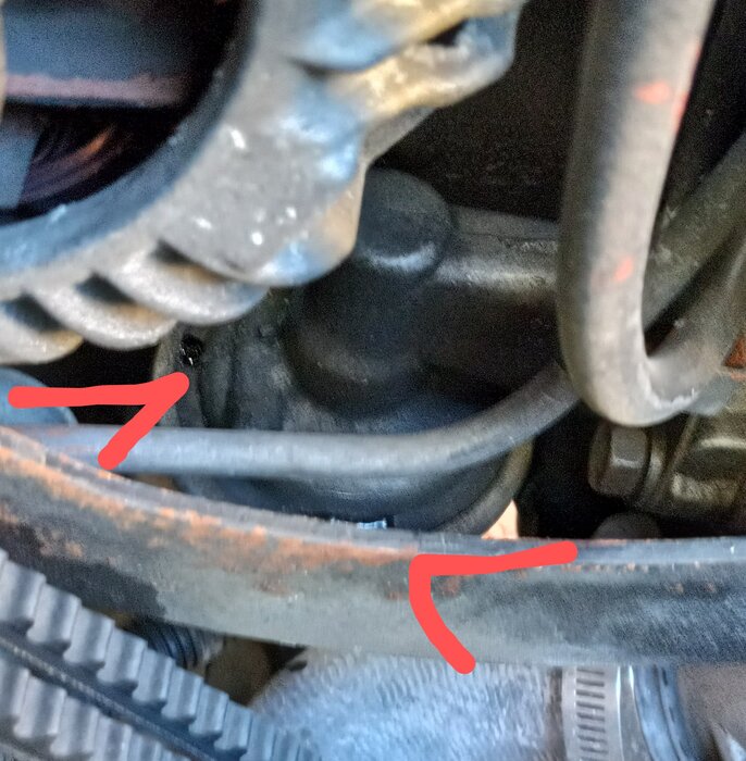

Hi Gang! I got Marty ('87 5th, stock) running really well now (I tried absolutely everything; finally drilling out, cleaning and adjusting mixture screws did the trick). But he's also developed a strong smell of gas while running. It does NOT seem to be coming from the carb. I can't see any actual leaks, but, there seems to be some wetish, brown tarry blobs on the top of the fuel pump itself. I can't see anything that could be dripping on it. Has anyone ever seen a fuel pump develop a leak like this? I will enclose some pictures from my phone.

Most likely gas coming out the weep hole indicates the diaphragm in the pump is going bad
7,098
2,812
Check your oil for gas also. It's rare but, I ran into a couple pumps that leaked gas into the crankcase. Like Volare said, fuel coming from the pump vent hole equals diaphragm starting to leak. If it leaks worse, it'll pump gas out the vent and if it gets in the alternator or plug boot, it can ruin you day real quick :eek:
