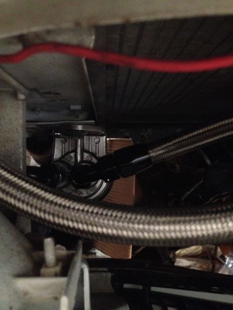

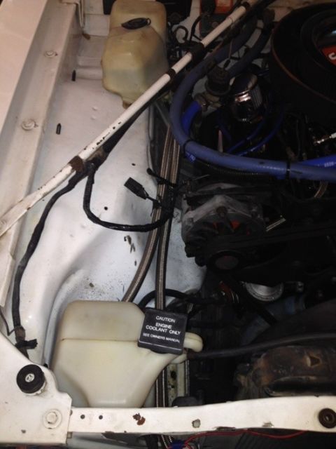

What I ended up doing is I installed a relocated oil filter to the rad support and the cooler runs off those lines. I used a good quality one and braided steel lines and now my filter is away from heat, so much easier to replace during oil changes, and there's ZERO seeping/leaking.

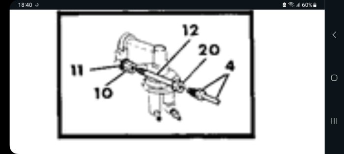

There were originally two different pumps. One for non-oil cooler cars, one for the squads with the cooler. The bolt (6033087) is actually hollow, and that's where the oil returns to the pan (via the front cover). All discontinued now.
If the bolt and adapter lines are all still good, what I've done is drilled out the hole a bit on the pump to accommodate the hollow bolt. Use a Carter or Delphi pump. They tend to last a bit longer.
