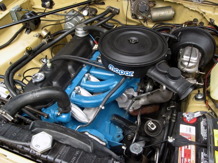

Second thought is you don't have the little pre heater hose hooked up like in this pic
See that tube below the front of the air cleaner snout? That pulls hot air off the manifold to the air cleaner.
