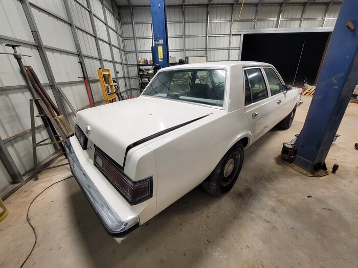

I suppose It would be rude if I didn't post pics of the M-body soon to be thoroughly molested with fancy parts and a sawzall.

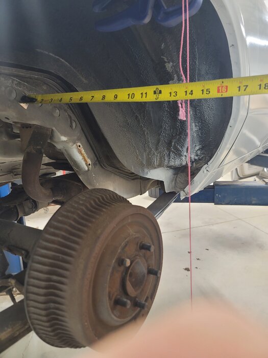

Although I'm a fan of the Pro-Street look, having grown up in the 80's & 90's, I'm going to be a little more subtle with this one at first.
While I'll probably move towards a ladder bar style suspension with coil overs to get away from the leaf springs, I'm going to try to only show a subtle change in the appearance of the rear tire/wheel combo.
Just getting rid of the leafs and opening up the wheel wells to the frame rail, I should be able to fit 12-13" of tire width in there. That'll be great for a fat street tire and plenty for a dedicated drag tire when needed. Just widening an OEM style steel wheel should give a little deeper of a dish without ruining the stock look.

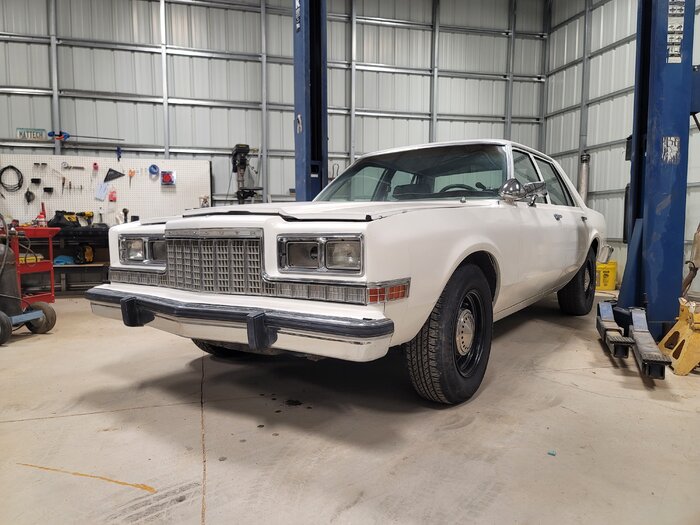

I can't get over how clean that car is. Makes we want to move out to the desert. :cool:
mattechperf
Jan 7, 2022
32
33
Phoenix, AZ
Originally from the Midwest, I'm still dumbstruck anytime I see a Suburban with it's rocker panels intact. I fully appreciate how solid this thing is.
That's why I won't cut this one up more than necessary. A little TLC and this should clean up nicely.

Reinforce the k-frame and lower control arms while you’re at it. They make some nice tubular upper control arms for these that really help things out.
