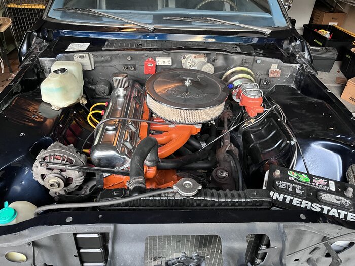

My name is Josh and I have been rebuilding a 79 Volare duster with a slant 6 for 8 years. The closer I get to done…the harder it seems. I upgraded the cam, carb, intake, exhaust, etc…but I can’t seem to advance the timing enough, the brake pedal won’t match up to the new brake booster and the body panels aren’t going back on very easily. Besides that…it’s a great car. Would love any help I can get. The goal was to drive this for my wedding in a few weeks, but I feel like id need a miracle at this point.

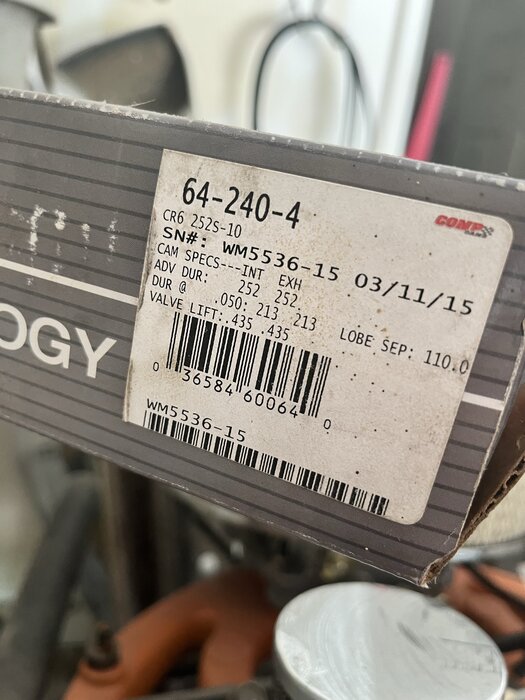

What specs on cam, carb, intake, ect? How is it running? If it is, what’s your timing at? Have a link to the brake booster you purchased?

Thanks! I provided the cam specs. It feels like it’s choking out. It’ll start with choke closed, runs for a moment…then slowly dies out. I’ve tried opening the choke, that also kills it. I’ve tried giving it a little gas, backfires a little then gives out. Im going to clean the carb. The carb is an edelbrock 1404 500cfm model. On hold now with comp cams to see what they say. Offenhauser intake, Hooker headers. I need to advance the timing a bit more, but if you’re familiar with the slant six, it only turns so far before removing and adjusting the cap. I also added the specs for the brake booster. I appreciate any help!

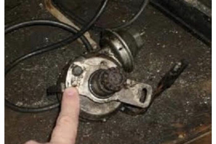

I haven’t been around a slant in a long time but, is there a way you’re able to physically re-clock the distributor body back on its shaft so, you’re able to get the clearance needed to rotate it further for, more advance? Want to say there’s an adjustment plate with a screw/bolt that you can loosen and adjust. You may have to pull the distributor to see it. It’s on the bottom side. I feel like that was a thing we had to do on my Moms, Duster.

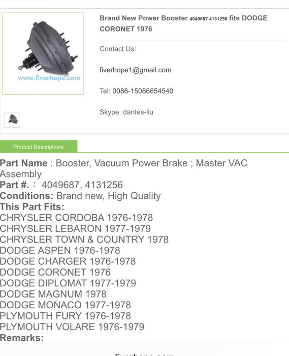

The brake booster deal, that’s for an A-body. If you can find something specific to/from F/M/J bodies you’ll have it installed in no time. Not sure what it would take to make that all work on the car.

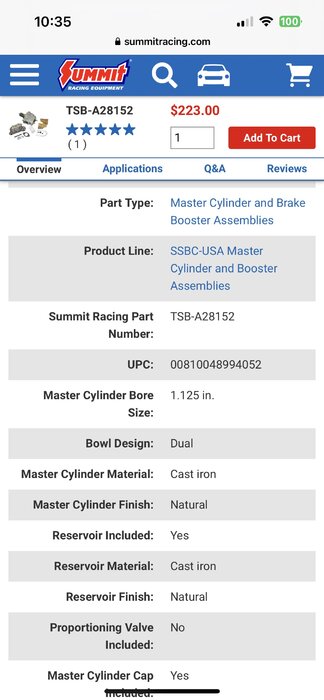

Backfires from the exhaust, so dial back the fuel on the carb…I’ll pull the distributor, I can also rotate back and not install the bolt and provide myself more room to advance. An “A” body…really? I’ll look for an f body specific model. Summit said that one would fit my car.
Summit said a Milodon oil pan wouldn't fit my car, I checked with the forum and the forum minds said it would fit.
I would trust the forum over Summit or Jegs any day. The FMJ cars are an abandoned platform that requires hands on knowledge.

Would this one work then? Would I still need the swivel linkage? Or does it connect directly to the pedal?

Photo of the bolt/adjustment plate I was thinking of on /6s.
