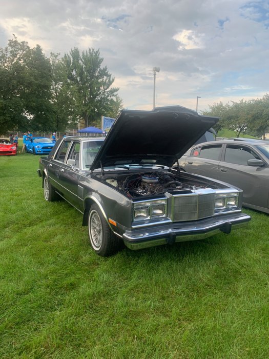

soon I am going to be getting some heads and headders for my 1984 5th ave now the thing I am trying to figure out is I hear that the aspen/volare has the same k frame/engine compartment as the m bodies is this true?? because i'd love to get some full length headders for it. my 5th ave has the stock 318 la in the heads gotta go their smoked valve guide seals leak so bad it's nuts so getting edelbrock performer heads for it but you guys know if aspen headders whould work on a 5th ave?? n this is the babby that's getting the goodies
